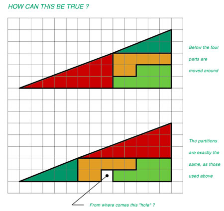

hehehe :)

I figured that triangle thing out long ago.
The angle is tweaked a bit.Try to draw an stait line along the triangle.And you will see that its aculy an 4 edge shape.One edge is very close to 180°.
