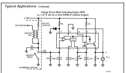

this is the reference design.
Hi Indecided,
I see a few things wrong that can cause your problem:
1) If you look closely at your "reference" circuit, it has a 7.5V zener diode at pin 9 of the LM29xx. That zener diode is included inside an LM2917, but your LM2905 doesn't have one. Add one to your circuit and it will probably work much better.
2) The circuit that you are using has an extra opamp-comparator and relay driver. Why is it using a lousy old 741 opamp when the LM2905 has a very good comparator and powerful output transistor built right in?
The 741 requires its inputs to be at least 3V away from its positive supply and ground (its negative supply), which is called its common-mode input voltage range. Your circuit has its inputs too close to ground. The opamp/comparator inside your LM2905 works very well with its inputs all the way down to ground.
The 741 is guaranteed to drive a 2Kohm load to only 10V, when using a dual 15V supply. That is a loss of 5V with a load current of only 5mA. The output transistor inside the LM2905 has a low loss and can drive a load current of 50mA.
3) The datasheet shows a 100Kohm resistor at pin 3 for an 8 cylinder engine and a 133Kohm one for 6 cylinders. Therefore use 200Kohms for 4 cylinders.
4) In addition to getting rid of the old 741 opamp, the LM2905's datasheet shows how to connect its opamp/comparator as a speed switch, which is what you want. Use a 10Kohm pot instead of its 5Kohm resistors to adjust its trip point. It might be accurate enough without a zener diode. It is using the 8-pin IC, the pin numbers are different if yours has 14 pins. Their circuit is here:

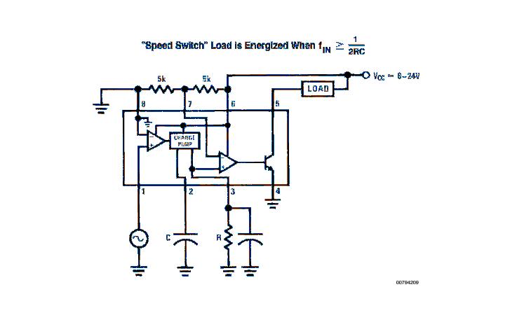

- The problem however.. is that is a speed switch. Useful for a door actuator lock at speed, or a speed limiter. The problem here however, is that i need to connect it as a REV comparator. not a speed.. so when I change gear i get notification.. not at a certain speed!
thanks! can you point me in the.. right direction?
Hi Indecided,
Did adding the zener diode help your circuit?
On your circuit, you are probably measuring the voltage that is too low at the output of the 741, which doesn't work. You should measure the voltage at the output of the LM2905 pins 5 and 10. Using 100K ohms at pin 3, its output should be 2.0V at 4000 RPM. Using 200K, it should be 4.0V. Reduce the value of the capacitor at pin 3 if it is too slow to respond, to 0.47uF or less.
The Speed Switch circuit connects to your engine, not your wheels, so it switches its output at a set RPM. Isn't that what you want? It will switch a relay, or an LED in series with a current-limiting resistor.

Hi Indecided,
Previously I was talking about an LM2905, but I really meant LM2907. Sorry.
It doesn't work? Now with the zener, it is exactly the same as your reference circuit.
Are you using the 14 pin version of the LM2907? The 8 pin version won't work with "breaker points".
Are you sure that your car has "breaker points"?

Hi Indecided,
Since your circuit works OK when the car's electric loads are on, then maybe its alternator voltage regulator outputs a lot of electrical noise without much load.
The circuit's 10K and 20K voltage divider make it very sensitive to noise from the points. Change the 10K resistor to 100K.

Hi Indecided,
Yes, change the 10K resistor that connects to the breaker points to 100K, to make the circuit's input less sensitive to electrical noise from the points.
Assuming that there is a lot of electrical noise without much load on the alternator, without the zener the circuit's supply voltage is bouncing around with the noise, making it less sensitive. With the zener, the supply noise is reduced so that the circuit works properly, however its input sensitivity is too high to handle that much noise on its input. You could also add a 100uF capacitor across the zener to filter the supply noise even more.
