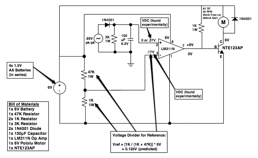

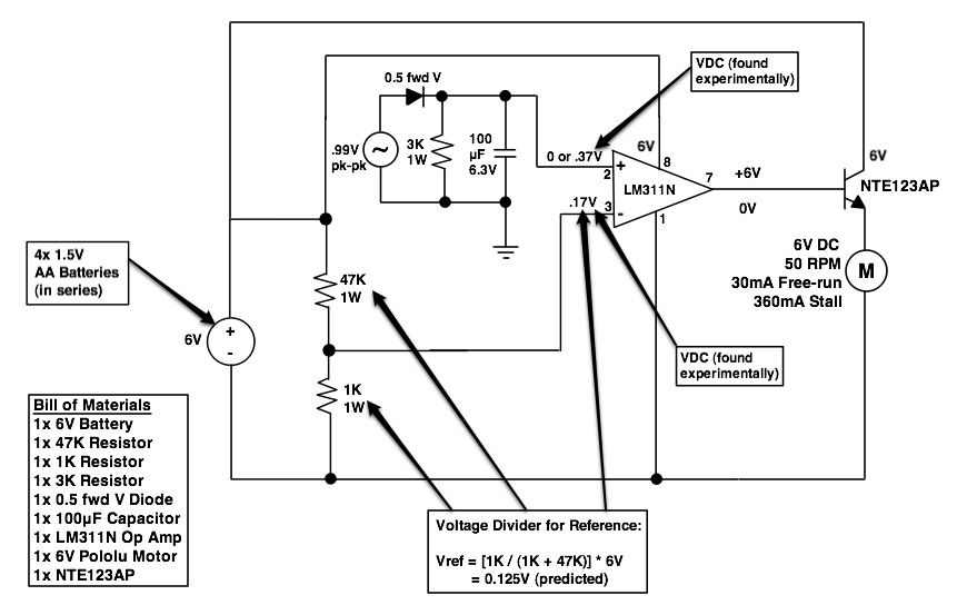

Hi I'm not an EE but I am building a circuit for a project that I'm working on. I built the circuit today but it doesn't work and I think the problem is either how I am am using the LM311N or possibly the NPN transistor.
The idea is:
-The AC voltage is either on or off, when on it is half-wave rectified and smoothed (turns out to be approx. 0.37V) and attached to pin 2.
-In order to set the reference voltage attached to pin 3, the battery voltage is divided (turns out to be approx. 0.17V)
-Ideally, the op amp would compare the two voltages and only output (pin 7) if 0.37VDC is achieved.
-The since i believe the op amp can't handle all the current required to run the motor (could be wrong), I am using an NPN transistor-- this could be part of the problem
Is there some glaring mistake I've made in the design? Am I allowed to ignore the other 3 pins of the op amp?
Thanks,
Peter

Check the LM311 datasheet, the output is open collector, you need a pull up resistor to +V.
EDIT:
I would also suggest you have the motor in the collector circuit of the transistor, add a suppression diode across the motor.

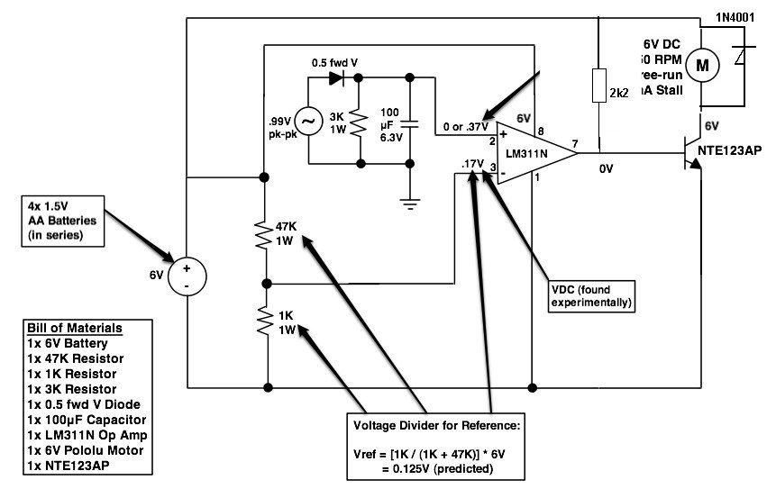

hi Peter,
Look at this, you may need to reduce the resistor to say 1K, to increase the base drive.
EDIT: the NTE123 is underrated for 360mA stall current, it could get hot.

Update
Hey Eric,
I updated the circuit (see attached)-- my multimeter reads 6.3ish VDC between the leads where the motor should be and doesn't change depending on the AC input.
Peter

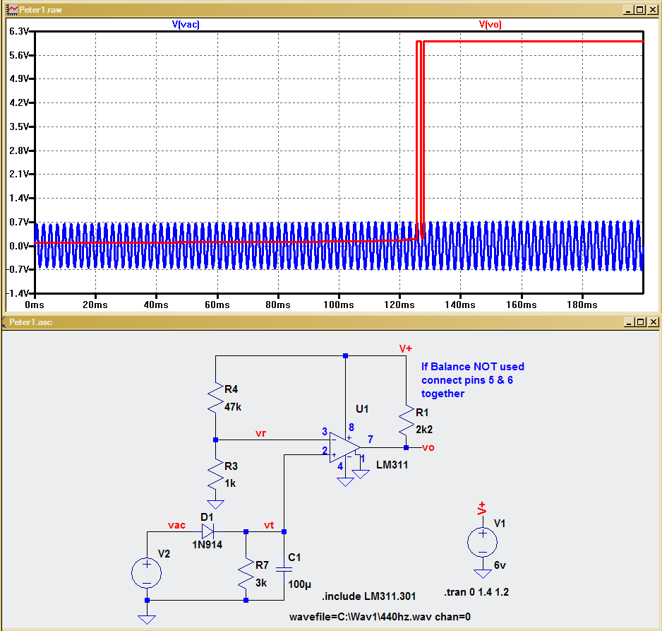

What voltage do you measure on pin #7 of the LM311.?? with respect to 0V.?
EDIT:
Looking at the circuit as whole, the voltages you added dont seem correct.???
0.786VDC between pin 7 and gnd
Ok,
That means the motor, if connected should be running.
Give me an hour or so and I will run your circuit in simulation and get back to you.
EDIT:

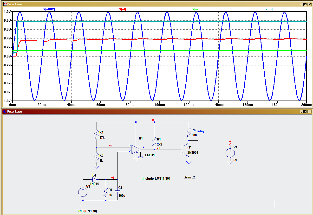

This is your circuit in LTspice, the motor will always be running.
What is the input freq of the 0.99Vac .??
The diode will drop approx 0.7V.?

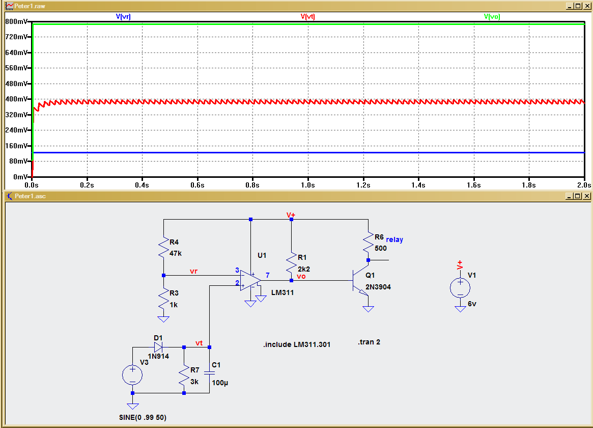

What is the frequency of the AC input.
A clearer image.
The input frequency is 440Hz-- just to make sure were talking about the same thing, I only want the motor to run if the DC signal into pin 2 is above the reference voltage.
Do you have pin 4 of the LM311 connected to 0V.?
It works in simulation.

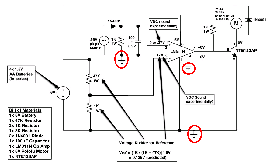

Ground is just the reference node for the circuit. In the attached drawing, the nodes circled in red all need to be connected together.
Wow i feel like an idiot! It works!!!

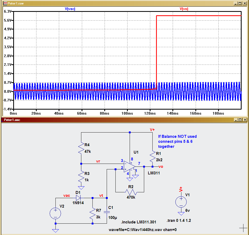

I ran a couple more sims, I would advise that you add the 470K hysteresis, else you have the 'jitter' at the threshold.
Look at the images
EDIT:
Just seen Roff's post,,, did you really have all the 0V's 'floating'.???? doh.!

1N4001 diode is very important, it protects your transistor, else you may need a fresh transistor everytime you run your circuit, and it has to be connected in reverse biased, else the motor will not work.
