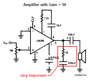

Colin's circuit with the LM386 amplifiers has both of them missing the very important 10 ohm resistor in series with a 47nF capacitor to ground at the outputs as shown on every circuit in the datasheet.
I think your head's stuck somewhere on "hi-fi", McDuck. That's what, a Zobel network on the output? How is that "very important" on an intercom, for chrissakes? We're talking about a "squawk box", not a piece of high-fidelity equipment here.
The Zobel network stops the LM386 amplifier IC from oscillation at a high frequency which causes severe distortion to audio and over-heating. That is why it is shown on all schematics on the datasheet. The LM386 little amplifier is not hi-fi but it sounds pretty good when it is connected properly as shown on the datasheet.
Well, I guess it wouldn't hurt (turns the load impedance essentially non-reactive), but is it really necessary on such a low-power device? What chances are there for oscillation in this circuit?
A speaker is an inductor and its reactance is a fairly high value and it causes phase shift at the frequencies where an audio amplifier will oscillate.
Don't argue with me about leaving the important inexpensive zobel network off. Instead you should argue with the manufacturer.
