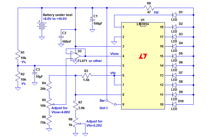

MrDeb...that circuit looks great, but I was wondering what the "TL071"
is (the name) and what it's doing for the vlow adjustment...If I want to up
the vhigh, do I decrease or increase R7/R8, and/or R3 ??

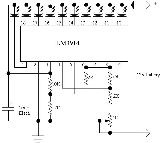

Here is a circuit that I have built. You can adjust the pot so the 13.8V turns on a LED in the bar graph where you want it.
Generally speaking, you can build a voltage divider that scales a 15V into to, say, 5V, and then set the LM391x to display 0 to 5V. That way, you could actually display 0 to 15V, but you could power the LM391x on only ~8V.
Hey, k7elp60, what is the size of the steps between the LEDs, if I adjust it to 13.8v
for the highest reading LED?
The voltage steps are approximately 0.22V. Here is what is happening with the circuit. The 10K and 2k in series from pin3 to ground give divide by 6 voltage divider for the input voltage. The 2K resistor from pin 6 to pin 7 gives the LED's in the bargraph 6mA of maximum current from the formula: 10(1.25/2kΩ). The reference voltage on pins 4 and 8 is adjusted by 1K pot.
For 13.8V as the higest voltage to be measured divided by 6=2.3V. This would be the voltage on pin 8 of the LM3914.
Because of some circuit inaccuracy's the steps may not be exactly the same.
But the circuit seems to work fine for me.
