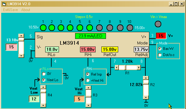

I am self educated in electronics and i know just the base ..
I have find some useful schematics in the Internet about building ''meters' with the LM3914
My project is to make some meters for my car ..
Oil temperature, RPM , Oil pressure , Battery meter etc...
I have install in my car the sensors and i measure them.. when it is cold the sensors give me 12v in their output signal.. and as the car works the sensors drop the voltage..
for example ''oil temp'' sensor at start gives 12v and after while when oil warm i have 8,9v
So my question is :
What can i do about the 12v signal ? the LM3914 as i read accept only 0-5v input signal ..
Should i place a resistor before the LM3914 input signal to drop 12v to 5 v ?
Next question :
If i understand well in the LM3914 every time we change the value of the input voltage it changes the status in the led...
let say that we have 1v so the LM3914 power on the 1s led , and when we place 2v signal then it powers on the 2nd led (as a bar or just only this one in dot mode)
can we make it work ''power on every time one led'' but when we reduce the voltage signal ?

Download this LM3914 module from this link, it should enable you to calculate the required resistors.
Afre you have downloaded *.txt file change the extension to *.exe
https://www.electro-tech-online.com/blogs/ericgibbs/136-single-dual-lm3914-v3-0-calculator.html

Thanks you my friend for the quick reply
the exe is very useful !! A big Bravo!! to the person tha made it..
this exe help me to understand that you can make it calculate from a specific voltage range as signal..
We have 0-12v max and we can make it start calculating from 4v-12v - Right?
Also i see that depending what we choose Ref inp or +vex Hi we can make it work from 0v-12v or 12v-0v as starting point
Now to my Basic question... can i use 12v maximum as signal in port 5 ? (Input )
Have to use a resistor ?

Extract from the datasheet states +/-35Vmax input on pin #5 without damage.
These two are OK,,,,4v-12v and 0v-12v, but the 12v-0v would require IMO an external OPA inverter.

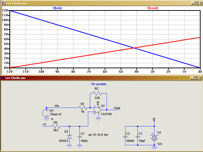

The 12 to 0v inversion I suggested in my earlier post would be something like this image.
Set the LM3914 to 0V to 6.2V
You just wire the LED's for the display to suit your pattern.
CAUTION:
An LM391x gets too hot if the supply voltage to its LEDs is higher than about 8V, the LM391x is set for a bar display, the LED current is set for 20mA or more, 2V red LEDs are used and all the LEDs are lighted.

Hi i would like some extra info about this schematic
1) The :
is the signal we take from our senders ??
2) The :
the V+ goes there where is V+ CA3140 ?
3) This one is a general one...
It will be wiser to use a LM 7806, 7809 to supply my senders instead of 12 v from cars battery ? so avoid false readings from dropped voltage (use hi beam at night )

This is the sender signal. If you give me more details of the actual sender, I can make any adjustment required.
2) The :
I would use a 7809 regulator connected to the car battery via suitable fusing etc,
The +V symbol then the 9V from the 7809 output.

Try to get a low voltage drop version of the 7809 regulator.
