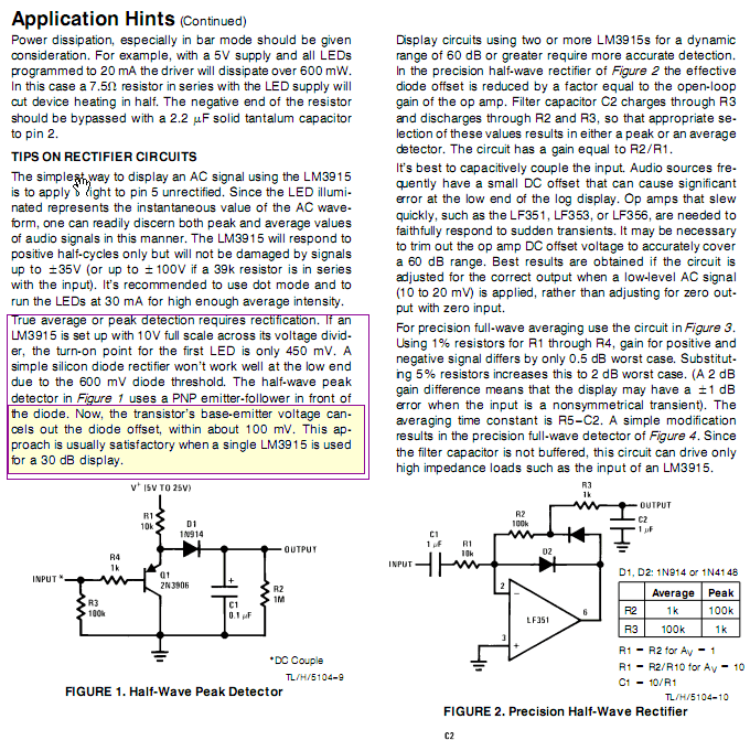

This image shows what the datasheet says about the accuracy of the simple rectifier circuit.
You have to decide on the degree of accuracy you want for a mP3 player display.
Well, I'm not looking for much accuracy here, more in the lines of visualization of the music audio. I probably will be happy if the LEDs are unlit during silence and fire up according to the music. I'm not sure how much accuracy this needs.

But isn't there still the problem of the LEDs already lit up? Lit even without any signal?
According to the datasheet the offset should be in the order of 100mV.

The pin 5 input of the LM3915 has a PNP transistor with a max positive input bias current of 0.1uA which causes an offset voltage of +0.1V max in R5.
The transistor has a typical base-emitter voltage of 0.65V and the diode has a very low current so its forward voltage is only 0.2V. Then the input of the LM3915 gets 0.65V - 0.2V= 0.45V. The 7th and LEDs above it will light when there is no signal.
If the reference voltage at pin 7 is set to 10V then the 1st LED turns on with an input of +0.45V so it might or might not turn on when there is no signal.
