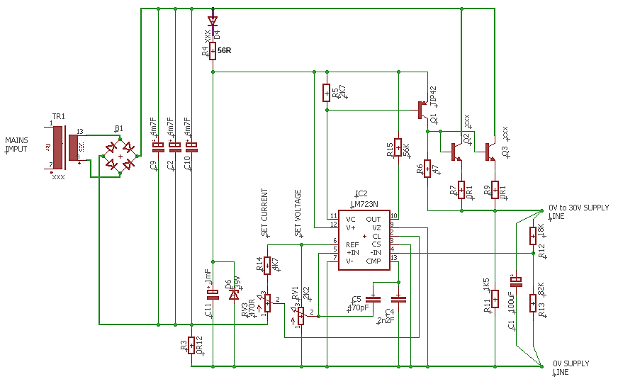

Here is a circuit diagram for a very simple but also very effective design for a PSU using LM723 and with an effective output of 0-30V as well as current limitation (0 to whatever maximum current you have the unit designed for)..
Output at full load (here 3A) remains at the maximum voltage rating due to the 30V AC transformer.
I recently dug up a PSU that I made during my student years and am now refurbishing: instead of an analog display of current and voltage I am incorporating a digital LCD display and a ATmega168 controller for both display and control functions (short circuit and temperature control).
I had a look around on the net to see if there were any similar designs but all I found were complicated designs using all sorts of zeners, transistors etc to try to get 0V output.
Therefor I decided to draw this circuit from the PCB on which I currently have it (I do not have the original drawing any more) and publish it here for your review.
So if you feel like it, please let me know yours opinions and comments.

Hy earckens,

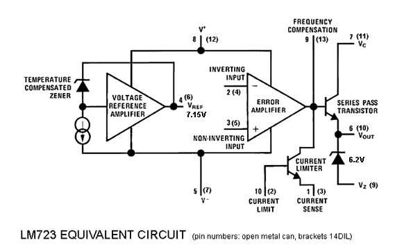

LM723 with 14DIL package pin out (just information):
(on your schematic of post #1, '- Comp' should read pin 4, not pin 5. Pin 8 should be open circuit)

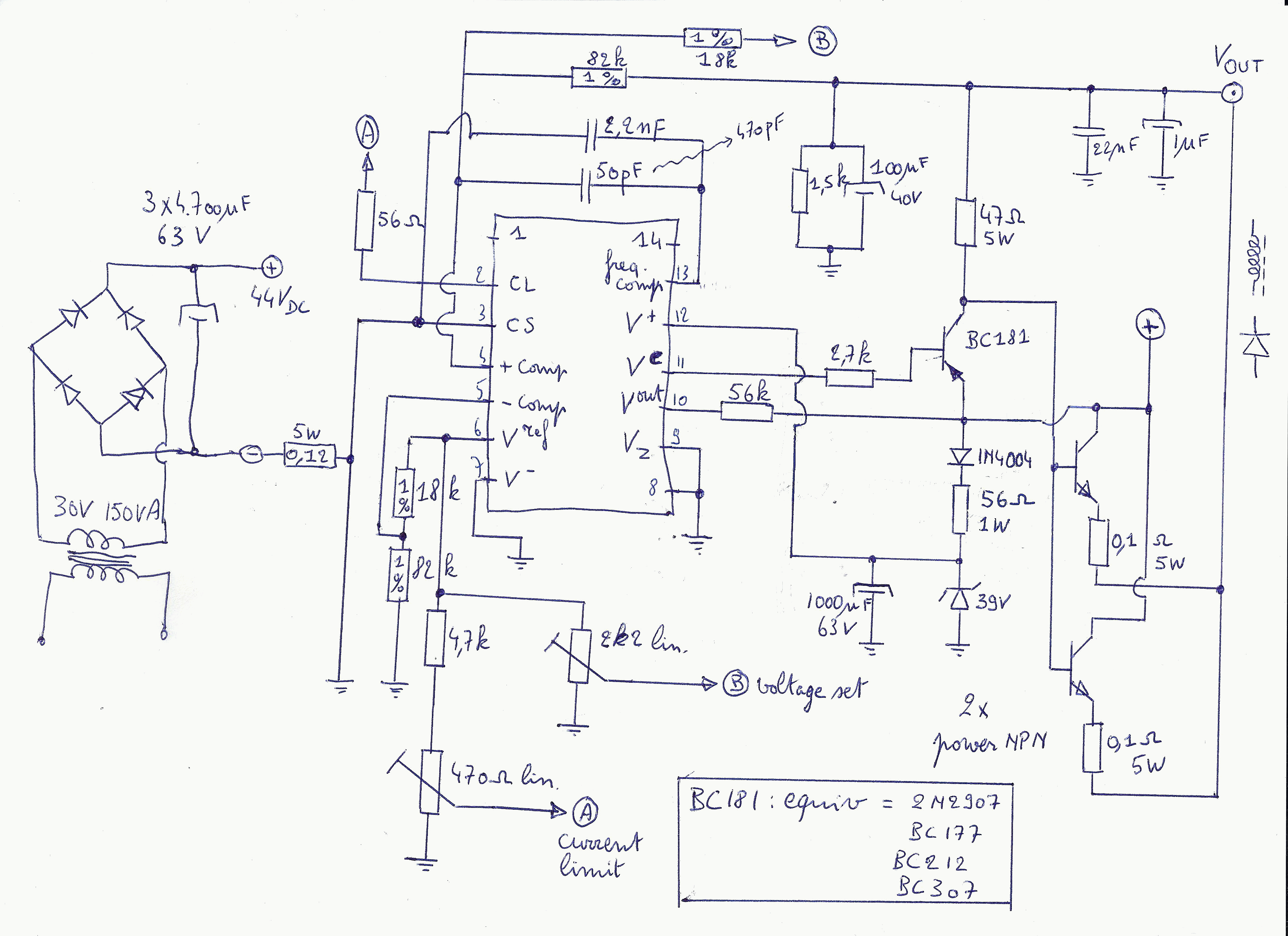

The BC181 used as driver for the power transistors is obsolete. Can anyone suggest some alternatives, preferably in TO220 or TO39 packages (the one I have is in TO39)? Max ratings: Ic=600mA, Vce=100V, hFE=30, P=0,5W (but a heat sink is necessary, it gets hot). I have a 2N2907a alternative but it is in the smaller TO18 package, too small for my heatsink.
A 2N2905A would make an excellent replacement for a BC181: https://www.onsemi.com/pub_link/Collateral/2N2905A-D.PDF
But I don't think that a TO39 transistor will be able to dissipate enough power in your power supply application. While I suspect that your circuit diagram is not correct, especially around the PNP driver transistor and the current limit, I would expect a transistor driving a couple of common collector power transistor, say 2N3055, to give 0V to 30V @ 0A to 3A, to have a maximum dissipation of around 6.6 Watts. So a TO220 transistor, say, would be required. For example, a TIP42C on a heatsink should be up to the job: https://www.onsemi.com/pub_link/Collateral/TIP41A-D.PDF

The schematic below is what I suspect your circuit should be.
See post #22 for a revised schematic 2016_08_29 OBSOLETE: see post #69
There are some points:
(1) Without transformer switching to reduce power, as the other members have mentioned , the dissipation in the output transistors would be 132 Watts total. Thus, for example, four 2N3055 transistors would be required, and they would need to be mounted on a heatsink of 2 degrees C/W or less.
(2) The minimum output current would be around 20 mA worst case with four 2N3055 output transistors. This could be negated by embodying a negative current sink.
(3) The current control would not be precise, because the current control relies on the VBE of a transitor, it includes some commutation current, and it includes the current consumed by the power supply circuits.
(4) There is no decoupling

Thank you very much spec! Your input is very valuable to me.
However, I do not fully understand your statement in line 2: "..minimum output current would be 20mA worst case.." and "..negated embodying a negative current sink.". Also line 4: "..no decoupling."?

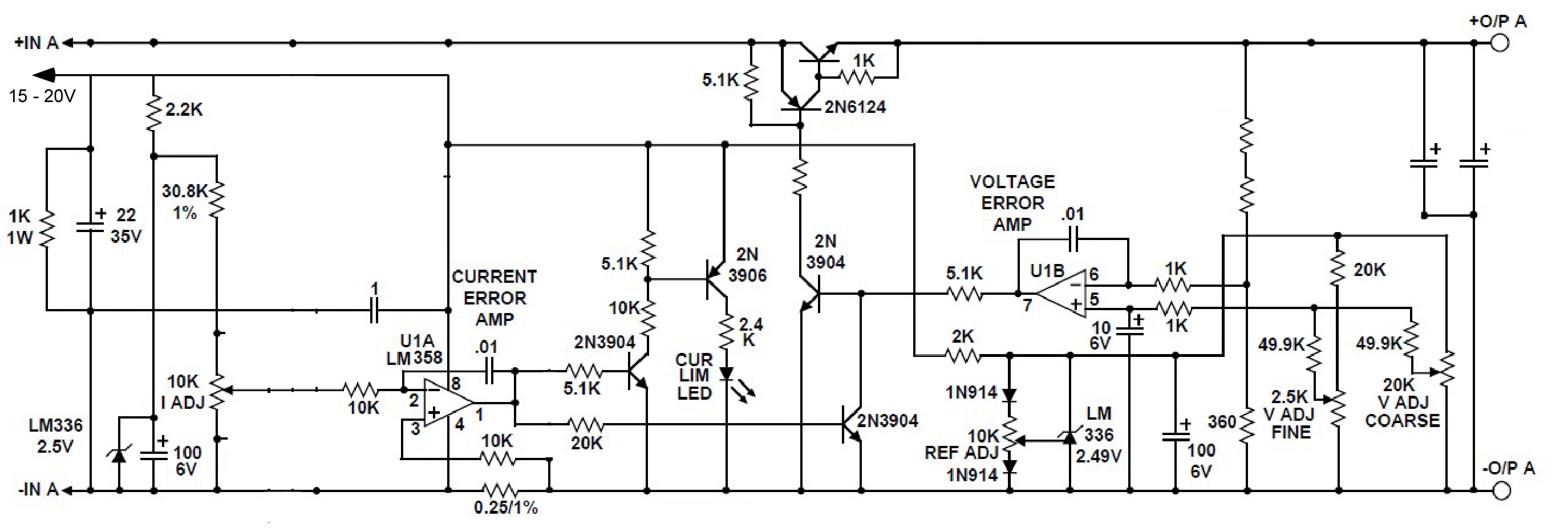

You need a relay. No it's not worht the effort, I would just bulid a switcher that regulates about 2V higher than VOUT and use a 2V linear supply to drop it down. You get low noise and fast transient response of a linear but high efficiency near switcher level.
No offense but the LM723 is a 70's era technology, I wouldn't build a design based on one. My lab supply is a linear using discreete circuitry. The main advantage of the LM723 was it had an on board reference and current limiting neither of which are decent performance level.
Here is a generic lab supply schematic that will give much higher performance.
Interesting circuit. What is the approx. current draw at the 15-20V input? What do you connect to IN A (transformer, rectifier and capacitors?)? The values of capacitors without unit is nF? Some resistor values are missing: can you give the values? What is the approx. rated output current here? What is the rated max output voltage? 1x 2N6124 seems a bit minimal for a 150VA transformer at the input?
This is a classic problem with power supplies. If you take the LM78xx series of three terminal regulators for example, the minimum output load current is 10mA. If you take less than 10mA the output voltage is liable to rise to the input voltage and there will be no regulation.
The reason for this is that the pass elements have a leakage current, which for the 2N3055 can be 5mA. So if you had four 2N3055 transistors in parallel the total leakage current could be 4 * 5mA = 20mA. Note that the 2N3055 specification says that the leakage current could be as high as 5mA at a junction temperature of 25 deg C. In fact, for any individual 2N3055, the leakage current could be a lot less. But the leakage current increases with junction temperature and the junction temperature of the 2N3055 transistors in your power supply is liable to be near the maximum allowable of 200 Deg C when the power supply is outputting a low voltage and 3A.
The way to negate the leakage current is to generate a simple negative supply line, from the existing mains transformer of -5V say and have a constant current generator sinking 30mA say, down to the -5V line. The brings other advantages too: better frequency stability and better voltage regulation at low output currents.
A schematic is an illusion. It does not represent the real world. Even a short piece of wire or printed circuit trace is composed of resistors, inductors, and capacitors.
The net result of this is that a circuit can oscillate or the components will not perform to specification. This is especially the case for high gain circuits, high frequency circuits, and precision circuits. For example, the average operational amplifier (opamp) has a voltage gain around one million and the 723 contains an opamp.
To negate the effect of parasitics (unwanted circuit components and couplings) you add decoupling capacitors and isolating resistors and inductors and also optimize the layout for maximum performance. That is why on a production equipment you often find all sorts of odd components splattered all over the place.
