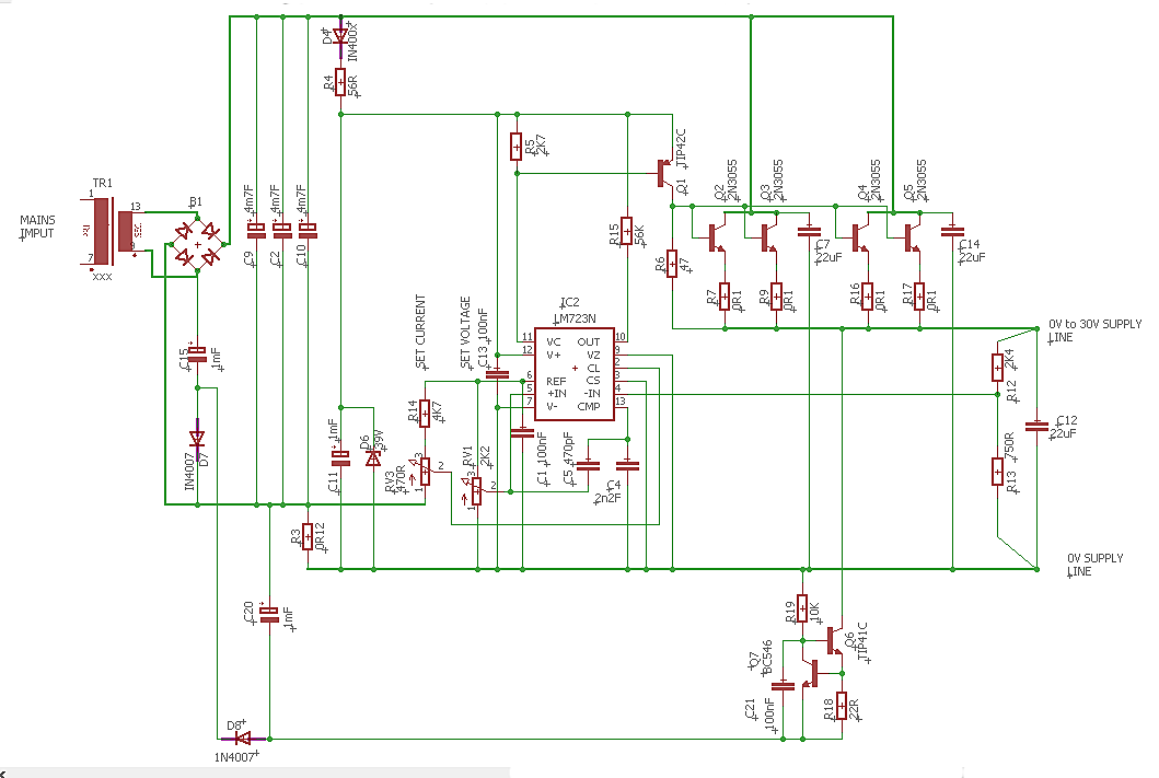

LM723 PSU with 0V lowest voltage

Here is a modified schematic of post #12 which includes:
(1) Four output transistors
(2) Decoupling
(3) Current sink

(1) Disconnect R19 top from 0V SUPPLY LINE. Connect R19 to D7 lower (cathode)
NOTES
(1) All non electrolytic decoupling capacitors are thru hole (not surface mount) ceramic, X7R dielectric, +- 10% or better.
(2) All frequency compensation capacitors are metal film type, +- 5% or better
(3) RV1 can be 5K wire would multi turn potentiometer to give fine adjustment
(4 RV3 can be 500R wire wound multi turn potentiometer to give fine adjustment

Interesting circuit. What is the approx. current draw at the 15-20V input? What do you connect to IN A (transformer, rectifier and capacitors?)? The values of capacitors without unit is nF? Some resistor values are missing: can you give the values? What is the approx. rated output current here? What is the rated max output voltage? 1x 2N6124 seems a bit minimal for a 150VA transformer at the input?
That's why it's generic. Some of the resistors determine what your output voltage range is. Caps are in uF. The 15V line current draw is probably in the 20 mA ballpark but that's a guess. INA is from the positive unregulated supply. Maximum feasible curent is like 4 - 5A ballpark depends on heatsink.
If you specify what output voltage and current range the unit must have, we can address component values.
The NPN transistor I used was a 2N5885, the 2n6124 is the PNP driver. To do 150W ps, you probably woud have to parallel four 2N5885.
Building a linear over 100W is not trivial. It takes serious heatsink knowledge and also SOA considerations on the power devices. I tend to agree it makess sense to buy one unless the objective is to learn in detail. That's why I did it, lot of time used but I take pride in the feat.
FYI, a 150VA transformer is only good for about 90W of DC load power using a diode bridge input configuration. The RMS current in the xformer is about 1.6X DC load current.

spec, I appreciate your efforts!! Can I ask you, while you are busy focussing on the LM723 layout to add a voltage fine adjust? I like that option on the generic layout from bountyhunter. I tried to do it myself but I am not so sure I get it right: in the generic layout from bountyhunter the voltages from two potmeters are added and forwarded tot the + comp (pin 5) but the pot values are much higher then in the LM723 layout and I am not sos sure that I can substitute the same or similar values.

Putting in a fine voltage adjust is simple but I would advise just making RV1 a multiturn potentiometer instead. The value of RV1 is not that critical, but 5K Ohm would be a good choice. https://www.ebay.co.uk/itm/10-turn-...UK-/121839695836?_trksid=p2141725.m3641.l6368
You could also make the current limit potentiometer multiturn too: 500 Ohms would do the job.

Issue 02 04 2016_08_30
ERRATA
(1) Connect R19 top to D7 lower (cathode)
NOTES
spec, you write "errata 1. connect R19 top to D7 lower (cathode)": is your drawing already corrected for this? If not I do not understand how it should be. Can you please explain? Thks

Hi spec, for Q7 (BC546) may I assume any NPN low power transistor (BC548, 2N2907A, 2N3904,.. ) would do as long as Vce > 30V?
ERRATA updated to make clearer. :)
spec
ok spec, that is clear.
Why not use ceramic capacitors for frequency compensation? Metalfilm does not go below 1nF, what if you need say 50pF, for example on pin 13 of the LM723?
X7R dialectic capacitors are good for decoupling because they have a low equivalent series resistance (ESR) and a high capacitance for their size, but their capacitance value varies wildly with both temperature and voltage across them. Small surface mount ceramic capacitors are particularly bad in this respect. Ceramic capacitors distort a signal badly too.
COG dialectic ceramic capacitors have much more stable characteristics but are much bigger for a given capacitance value and more expensive.
For frequency compensation, as well as a reasonably low ESR, you want stable capacitance and low distortion so you would go for another type of capacitor: polyester, polycarbonate, silver mica and so on.

Avoid using Y5F or Z5U dielectric they are complete junk. X5R and X7R are best buy and good quality.
