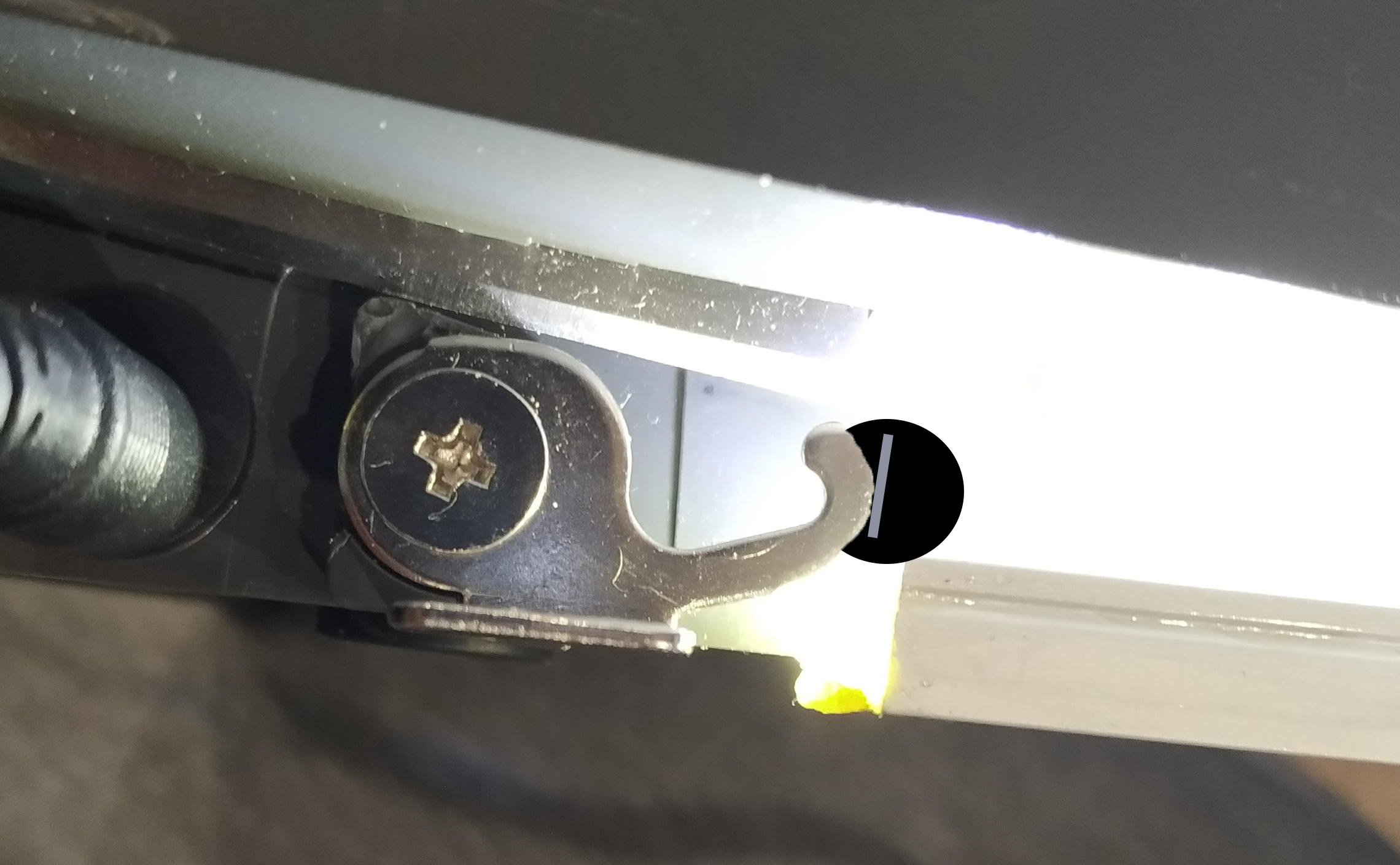

From the next to last photo, could you fit a microswitch inside the base with the tip of the lever through so the outer curve of the lock "hook" operates it, when it is in the unlocked position?
Pair that with the one as I suggested earlier to be operated by the blade being fully down, with the two in parallel, so the lamp is only off with blade down AND latch not unlocked?
Sounds perfect, that's exactly how it should operate. I'm struggling to imagine how it would be installed and what it would look like.
The hook is mounted on the outside of the guillotine and the hook slot is in the handle, so I'm not sure how that would work?
Have the switch lever sticking out a hole in the frame, so the end is just far enough out for the lock hook to press it, when in the unlocked position.
Wire that in parallel with another switch, again ith the lever through a hole, that's operated when the blade is fully down,
Use the normally closed contacts on both switches, so if either is not pressed (blade up or not locked) the light is on.

The grey line in the guillotine modification image represents the end-on view of the switch lever, with the switch body to the right of the hole, inside the base.
For the blade switch, mark the blade edge position where it's fully down then drill a hole centred on that, somewhere towards the front, where there is space in the body to mount a similar switch.
If the lever is set to protrude slightly through the hole, the blade can press it as it gets fully down.
Fit the lock switch first, as that can only go in one position.
