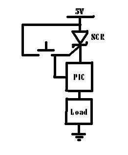

I'm planning to use SCR in my circuit but im having a problem of trying to find a low power SCR. What I have is a circuit with 5v supply and current consumption of 20mA maximum. Is there any SCR suited for this operation? If not, what can you suggest for replacement? What ive come up so far are SCR's for high voltage/amps circuits.
By the way, here's what my circuit will do:
A pushbutton will be push momentarily, thus enabling the current flow to the circuit.
A PIC will disable the SCR by applying '0' to the gate of the SCR
Question: Will a '0' from the output of the PIC disable the SCR?

No, once turned on and SCR will not stop conduction even when the gate signal is removed. Current through the SCR has to drop to a very low value (<20ma or less) before the SCR will turn off.

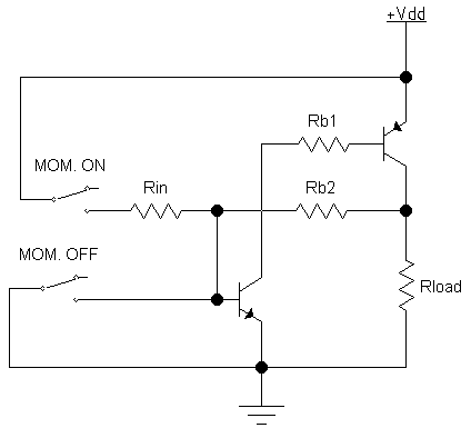

As Eric noted, you can make an SCR equivalent with two transistors (an NPN and a PNP). That circuit can be turned off by applying 0V to (grounding) the control input.

No you cant. Once it's on; it's latched on until you disable power.
I beg to differ. The transistor circuit allows access to the base drive to the lower transistor. If you short that to ground, it turns off the lower transistor and shuts off the latch. It acts rather like a GTO (gate turn off) thyristor. (See the attached schematic)

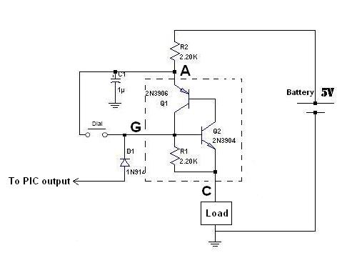

Attached is the circuit im planning to do:
* The pushbutton will be pressed to start the operation
* The circuit will run for sometime after button is pressed
* The PIC will send a signal to the gate of the SCR to disable it (if possible)
* The circuit stop conducting

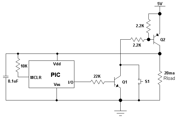

From your textual description, you could do this:
pic-scr-latch-sch-gif.24442
When S1 is pressed, it turns on Q2 which supplies power to the PIC and the load. The PIC, after reset/power up, outputs a high on the I/O pin which turns on Q1. Q1 turns on and keeps Q2 turned on also. Then the PIC does whatever, timing, etc that it needs to do. When done, the PIC outputs a low on the IO port which turns off power to itself and the load.

Guys,
This is what I did with my design. It works perfectly base on what I want it to do.
* The circuit stops conducting
But I haven't tested it with the PIC yet. What I did was connect the wire intended for the PIC to ground to stop the circuit from conducting. Its really weird though if you try to remove the 1uF capacitor. What happens is that, once you remove the battery and then connect it back, the circuit doesnt reset. So if the last state was ON when removing the battery, the circuit will be ON when you connect it back.

The PIC will not be able to turn off the circuit as shown, only turn it on. You need to pull point G to ground to shut the circuit off. To do that you also need to add a resistor in series with the collector of Q1.
If you place the PIC output in a high impedance state, then you don't need the diode to the PIC. To turn it off, just put the PIC output in a logic 0 state. Or you could add another transistor from point G to ground contolled by the PIC.
I have some questions regarding the behaviour of my ciruict shown above. what happens is that when I activate the SCR and remove the batteries, the system doesn,t reset as soon as I connect the batteries back. It shows some form/behaviour of a memory which stores the last configuration and runs that configuration when batteries are reconnected. Is this how SCR really behaves?
By state, you mean whether it was on or off? Or something more complicated?
yes by state, I mean ON or OFF..
the circuit automatically turns ON when the last state before removing the batteries is ON.
