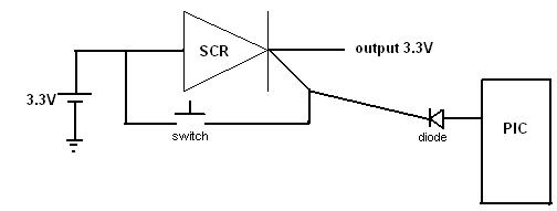

The PIC will not be able to turn off the circuit as shown, only turn it on. You need to pull point G to ground to shut the circuit off. To do that you also need to add a resistor in series with the collector of Q1.
If you place the PIC output in a high impedance state, then you don't need the diode to the PIC. To turn it off, just put the PIC output in a logic 0 state. Or you could add another transistor from point G to ground contolled by the PIC.

Thanks for your reply guys.:) Bt the way i've attached the circuit diagram.
  • The switch will trigger the SCR to turn ON
  • SCR will continue to run no matter the condition of the switch
  • PIC will turn OFF the SCR when a "low" signal is set
I placed a diode on the PIC to protect it from the +voltage. I was worried that the +voltage might damge the PIC port. Are my assumptions right? Also, I can't set the PIC port with the corresponding TRIS* at the beggining of the program since it may affect the operation of the SCR.
nope...
the PIC would have no trouble with the voltage since it is running off a higher one.
The direction of the diode would be to turn on not off the SCR.
Assuming you could turn off the SCR that way the PIC would have no where near enough output current to do so.
Why are you not just using a FET?
By the way, the PIC will get its supply voltage from the output of the SCR. So, it will have a supply voltage of 3.3V. I don't know how to use FET. Is it MOSFET I should use? Will it function the same way the SCR works in my circuit?
