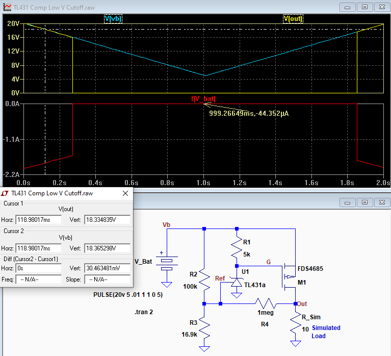

Here's my simulation of the circuit.
The voltage drop when the MOSFET is on is only about 30mV, and the OFF battery current drain is only 44uA, so I don't understand the problems you say you have (?).
Note that a value of 10k ohms for R1 is too large for proper switching of the MOSFET due to the current draw of the TL431.
It should be no larger than 5k ohms.
