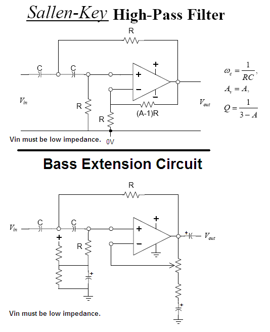

I use a second-order Sallen and Key highpass filter with too much boost to make a bass boost circuit. The pot adjusts how much positive feedback there is. I set them for +10dB at 30hz.
