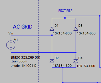

LTspice AC/DC convertor
I noticed that I got so high (power w) losses in the diodes, that it is not reasonable (I think). Do I need to change my diodes in the rectifier bridge?
And in that case, which one would suit me best? It seems that I do not know what to select...
For 4 A - Diode 1 - 212 W, Diode 2 - 728u, Diode 3 - 332uW and Diode 4 - 212 W.

The inrush current effect during the first quarter-cycle of the mains is what you are seeing. Two of the diodes of the bridge (D1 and D4) are subject to this but the other two are not. Since the mains phase position at power-up of a real circuit is not predictable, any of the diodes could be affected in practice, so all diodes should be the same type. An inrush-limiting NTC resistor could be used in series between the mains source and the bridge.
Aha I see. Is it enough to connect a regular resistor, lets say 1kohm or something. Or do I need to find a NTC resistor?
Do you know where I can find it?
