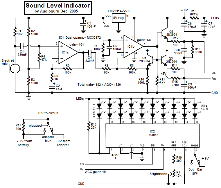

hi Mike,
I think your previous circuit did not work properly because the pins on the BC548 transistor were backwards.
The 1uF capacitor at pin 5 to ground charges quickly through the diode then it discharges slower through the resistor so your eyes can see the peak. They are called a peak detector circuit. The diode should be inside the feedback loop of an opamp.
My Sound Level Indicator project also uses an LM3915 and the range extends to 50dB because it has automatic gain control. Its input is a microphone and its LEDs do what you want.
want.
Why would someone put a AGC circuit in a VU meter ? :D :D :D
on1aag.
on1aag.
The range of a single LM3915 is only 30dB. I used to have a VU meter with two cascaded LM3915 ICs with a range of 60dB which was too much.
My circuit with AGC detects a pin dropping on the floor of the next room or people quietly talking, and also shows pretty loud music.

A VU meter for a microphone is simple. The microphone needs a preamp to feed a power amplifier or a recorder so the LM3915 uses the output of the preamp as its input.

Mine has been running continuously for 7 and one-half years and still works perfectly. The original 9V Ni-Cad rechargeable battery failed then was replaced by a modern Ni-MH 9V rechargeable battery but I rarely use the battery to power it.
Thanks audioguru, mine runs from a 120/12v plugin AC transformer, through a bridge and filter, and a LM7812 @ 12V DC, as I am driving 3 LEDs per output of all different colors, (3 blue, 3 red, 3green, 3 purple, ect), R7 is 910 gives about 14ma, and the LEDs are good and bright, and nothing gets hot or even very warm, even in bar mode. I like it, it works great, and on real loud sounds you can see it does kick down a notch or two to compensate. Thanks again.
