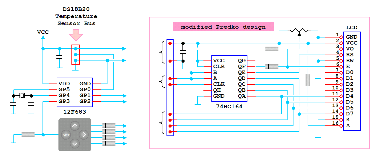

Well if you're using a '174 or '164 for the LCD interface you might consider using those four latched LCD outputs to drive a switch matrix. You would use one additional pin on the PIC to read the switches. Let me know if you need details...

Well if you're using a '174 or '164 for the LCD interface you might consider using those four latched LCD outputs to drive a switch matrix. You would use one addition pin on the PIC to read the switches. Let me know if you need details...

The procedure for reading the switch matrix on the latched outputs of the 2 pin 74HC164 interface is relatively simple. Here's an "untested" example;

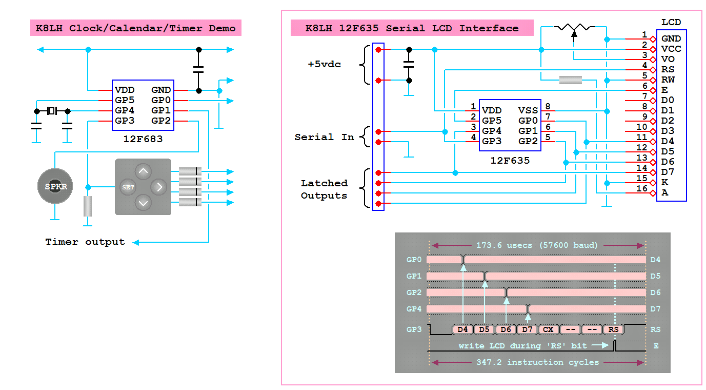

BTW, I use the latched outputs on my little 1 pin 12F635 serial LCD interface the same way (drawing below). It works great (1 pin for the LCD and 1 pin to read the switches).
You can also connect a 3x4, 4x4, or 5x4 keypad to the latched outputs but this would require 3, 4, or 5 PIC pins, respectively, to read the switches.
