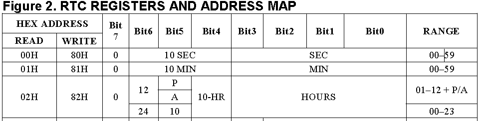

Hey this is what i have for my BCD to Decimal code so since i got lost in the other one:
unsigned char bcd2dec(unsigned char aBCD, char type)
    char lowNyb = aBCD & 0x0F;
    char highNyb = aBCD >> 4;
    char MyDec = lowNyb;
    char x;
    switch(type)
        case 0:
            highNyb &= 0x0F;
            break;
        case 1:
            highNyb &= 0x01;
            break;
        case 2:
            highNyb &= 0x03;
            break;
        case 3:
            highNyb &= 0x07;
            break;
    for(x=0;x<highNyb;x++){
        MyDec += 10;
    return MyDec;
the type feature is useful for RTC like the DS1306 and others... what is does is depending on the actual byte of BCD it may need less info for correct number like look at the hour field:
rtca-png.24799
The upper nybble only has 1 usable bit which is #4. The others (7:5) isnt usefull when converting from BCD to DECIMAL. The other info like AM/PM and 12/24 is extracted from another part of the program so its ok to toss it out here.
When you set it to 0 nothing changes. All are intact
When you set it to 1 it leaves the last digit intact and sets the rest to 0.
when you set it to 2 it leaves bits 0 & 1 intact and sets bits 2 & 3 to 0
when you set it to 3 it leaves bits 0,1,2 intact and sets bit 3 to 0
Nice heh.
