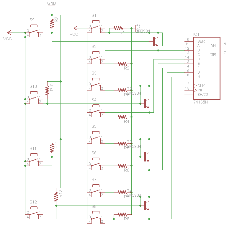

Ill post updates.. here is a schematic i was playing with this idea. It would be nice to connect 255 switches to this 1 sn74ls165. I drew small schematic example on how t okeep connecting them.
EDIT:
Below image explained:
basically the transistor connects 2 or more lines together forming double or tripple etcc. highs
Like when you press button #9 it connects button 1 and 2 together and sets them high this way you are sending 00000011 its like pressing 1 and 2 at the same time.

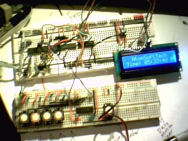

i did the Am/Pm stuff but the alarm and date will have to wait for another day. Im tired of thinking about this project lol. I need to relax my brain on this. Here is a so far PIC:

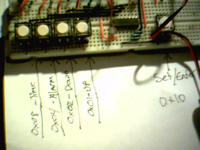

hi atom.
Looking at your images, do the push buttons have PU or PD resistors.?
PD.. it works now tho. i have them on 4.7k pull downs so when nothing is pressed it shows as 0. I just have to replace the code:

A good space saver for PU or PD are SILR's from 5 thru 9 resistors/SIL.
