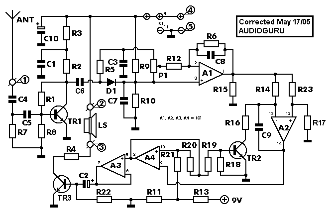

Lotsa stuff on the web is wrong.
Another electronics chat site has many projects that had serious errors that I fixed.
Here is an Electronic Eavesdropping Device Detector (detects a spy transmitter) that had its schematic totally messed-up. I don't know if anyone built my corrected version. Since it is wide bandwidth and has a high gain I think it would just pickup every radio station, TV transmitter and taxi-cab in town.
https://www.electronics-lab.com/projects/rf/005/index.html
It has a neat VCO that causes its speaker to begin slowly clicking when it detects a very weak signal then makes a low frequency growl with a slightly stronger signal. Its speaker's pitch keeps increasing as the signal gets stronger which occurs as it gets closer the spy transmitter. :lol:
