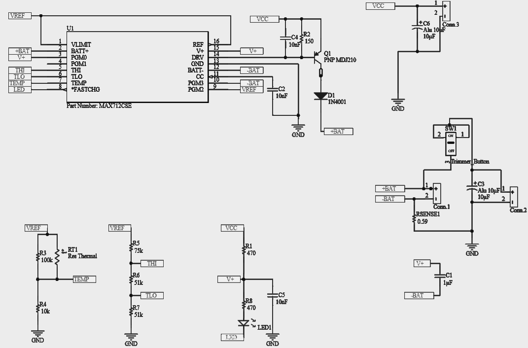

Hello, I've got news ! thank you for your replies.
Well, I feel that I'm really close.
I took a new PCB, soldered new components and took a MAX713 chip from Mouser (last one, untouched till now).
I wired everything, from 6V to 8V (R1 changed to 150 Ohm), and I still have those "switching" pulses by measuring the shunt voltage.
I've also measured DRV pin, and it confirms the switching behavior.
Please find attached the schematics in better color, also the oscilloscope readings.
Can it be related to the PNP ? even if I don't think so...
I've checked voltages:
V+: from 4.5V to 5V when I raise input voltage
Vref and Vlimit : 2V
BAT+ = 2.8V on fastcharge
Temp voltages 100% corresponding to calculations done.
Any ideas ?
I really hope some of you will continue helping...thank you very much

I've did some calculations, and still don't understand as from the datasheet, to calculate C2 (current regulation loop capacitor) here are the equations:
BWCRLin Hz = gm/C2, C2 in farads,gm = 0.0018 Siemens
fBin Hz = fT/Bo, fTin Hz, Bo= DC current gain
BWCRL< fB
From MJD200 datasheet, picture attached.
And finally you'll find my calculations and results attached as well, on CC regulation table (picture attached & Excel).

According to Wikipedia, "Under a light load (0.5 ampere), the starting voltage of a freshly charged AA NiMH cell in good condition is about 1.4 volts." So your BAT+ voltage seems reasonable.
I'm still not able to make understand where the switching is coming from, I'm upping this topic hoping that someone will read and give some advice.
Thank you very much.
My guess is that there is something causing the input V+ to drop. As per p10 of the datasheet,
"When the input voltage at DC IN drops below the 1.5V + (1.9V x number of cells), the part oscillates between fast charge and trickle charge".

Have you 'scoped V+ to see if there are any transients there?
Hello,
Yep I've did it, first, monitored VCC and it was oscillating between 4.5V and 6.2V, then I added a big capacitor and it stayed very..very stable at 6.2V, but the DRV pin behavior persisted.

I have a question that sounds maybe stupid, but in PNP transistor, do we agree that the collector goes to the diode and battery, and the Emitter is connected to VCC.
Because, I've reverted the transistor (emitter-collector) and wired it as a NPN one, and even if the switching behavior is still here, it somehow changed.
Current flowing to the transistor is higher and the ON pulses are longer, also, V+ voltage is stable.
I'm really tearing off my hair to know why is this happening and what's the rootcause of those switching pulses....
Yes.
What load current are you drawing during the charge process? Is it an intermittent or continuous load?
What is the current rating of your wall-wart output?

Getting desperate here, but have you tried alternative batteries to see if the switching glitches occur with all of them?
Is a current limit set on whichever supply you are using?

Well, what I did now is to put everything on a proofboard, and the good think is that the issue is still here, which means it's repeatable and not related no layout/soldering.
BUT, I've tried to remove that MDJ200 PNP and replace it with small S9012 and the behavior changed completely.
Now the linear regulation is happening and I even tried with 2N3906 and I have the same result.
However I have two questions if you mind:
- Why the first transistor behaved the way it did ? (kind of pwm like the max was resetting)
- Why the Max is regulating the voltage to ~130mV instead of 250mV on the shunt ? (image related)
EDIT: Sorry for double message, it's an error.
Well, my bad as I rewired everything I switched between transistor collector and base which explains the behavior.
After correcting that, the switching behavior is still here.
As I'm on a proof board I can change pretty much everything, so I tried to raise (and reduce) current control capacitor, which lead to same result, except the time between two pulses that was shorter or longer.
