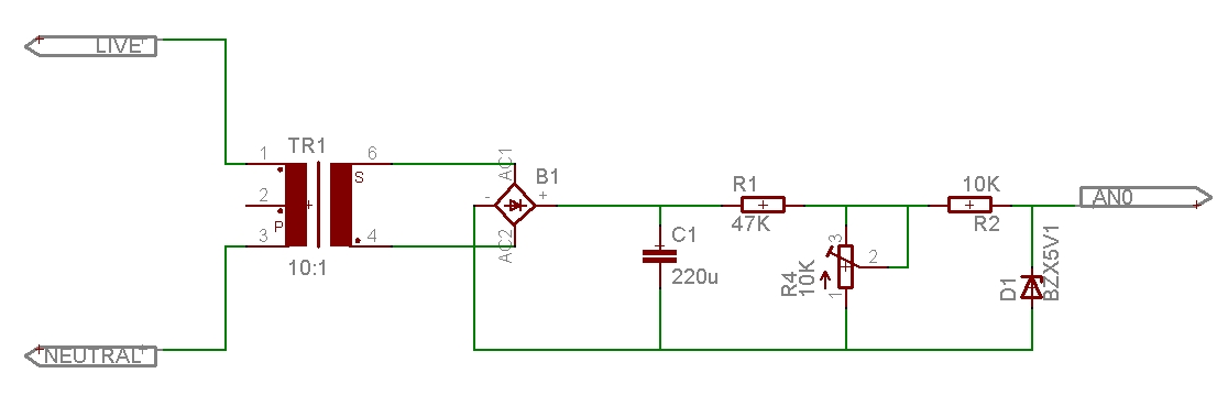

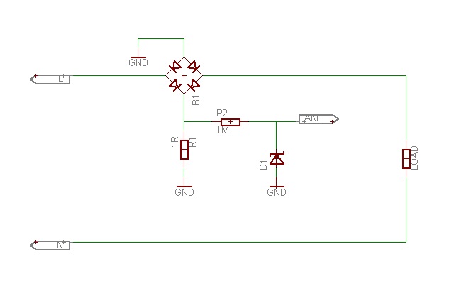

I have got the PIC reading several analogue inputs and sending the data up the serial to a PC. My next problem is the high voltage part - I've come up with some circuits for the current measurement but is there any problems with doing it this way or is isolation required?

Your first circuit is highly dangerous, please dont use it!
There is no isolation form the mains.
I suggets that you use a small mains transformer to provide isolation and transform the 240v down to 12v or so.
Then rectify and scale the to give the require reading on the PIC.
The second circuit may work, but is rather unconventional, using a resistor/transformer like that.
To measure current, I suggest you use a current transformer.

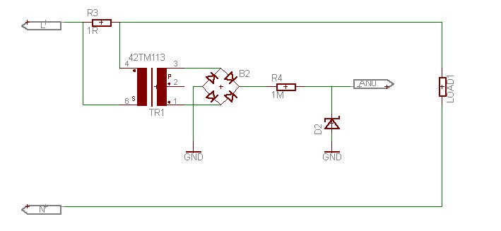

Is there anything inherently wrong with the transformer across a shunt resistor - sensitivity, accuracy, isolation, etc? I was going to put a 12v 500mA transformer with the low voltage side across the shunt to boost the voltage and minimise the diode drop in the bridge.
