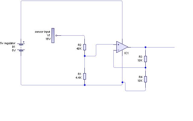

iv attached a circuit that i made from info in one of the last posts by picbits, iv not added any filters yet but is this the right sort of idea. i under stand that the opamp will never go above 3.2 volts so the pic is safe.
does it need a filter after it, ie resistors and caps.
regards jason
Notice my circuit has a resistor from the opamp to the PIC, this keeps the PIC safe. Have a study of opamps, and then ask yourself why R4 is there?.
Before it would make more sense - you want to protect the opamp as well.
I only put the filter after the opamp so I interfere with the input signal as little as possible. Some of the crankshaft/camshaft sensors use a high frequency drive to them so I'm a little wary about putting any capacitance on thats side of the opamp.
In practice it probably wouldn't affect them too much but as I'm desigining stuff for use on customers cars I wouldn't want to take the chance.
It wouldn't affect them at all, as it's after an attenuator.
You probably also need to re-eveluate your understanding of 'high frequency' :D
