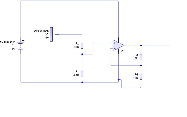

Notice my circuit has a resistor from the opamp to the PIC, this keeps the PIC safe. Have a study of opamps, and then ask yourself why R4 is there?.
when you say the resistor after the pic protects it, do you meen it stops the pic being damaged if the opamp shorts out.
as for R4 iv got no idea, these opamps are doing my brain in. i get how to use them as a follower or how to get gain from them but just not getting the negitive side of things.
surfing the net now to try and find things out
do i need to worry about using the opamp to go negative like in nigels diagram or can i just use the same sort of layout i attached earlyer to one of my posts, but add filter
is the filter just to stop high frequancys being sent to the pic???
If your opamp is connected between 0V and 5V it can't go negative, because there's no negative voltage there. In my case the resistor from the opamp to the PIC protects it both ways.
It's not just a filter, part of it should be (see nyquist frequency), but it needs to stop big nasty spikes as well.
so are you saying my nyquist frequency has to be half the frequancy i am sampling.
how do i work out how often i need to sample a signal from the engine???
what sort of filter layout stops power spikes
im guessing after the opamp there carnt be really any spikes becoz the max it can go to is 3.2v when the rail voltage is 5v but the spike could blow the opamp so i need to protect the opamp from high spikes with the filter

ok iv looked at all the different things you have said and iv attached a circuit that iv made trying to take into consideration everything. am i on the right track
wrong picture, ill do it again

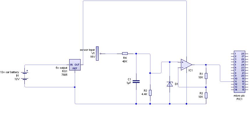

That's getting something like (I'm presuming you're just not showing the power supply capacitors and filter components?.
But like I've said before, you've still got bizarre feedback components round the opamp? - you're using it simply as a buffer for an attenuator, yet you're giving it a gain of two?. Remove both resistors and connect the output directly to the inverting input - giving a gain of one.
if i dont have a gain on the opamp the voltage at the a2d when the battery voltage is 16v is 1.6v,is that not to low.
when you say power supply caps and filters do you mean before the regulator because after i posted it i fault i just protect the regulator from spikes etc, could i do the same with another zener
Calculate the values of the attenuator to give the correct range you need, and save two resistors!. Or you could cheat (like my tutorial hardware) and make it variable gain! :)
You need lots of filtering, and very specific protection, on car powered items - there's been lots of threads here discussing it, it's a very complex (and argumentative) subject. But you require two capacitors on the regulator, and one across the PIC - as an absolute minimum, again check my tutorial hardware, which uses the absolute bare minimum.

jay543_uk said:
ok iv had a look at your tutorial processor board and i see the caps before and after the regulator, why does a cap stop the power spikes, does the cap absorb the spike because it trys to charge to the spike voltage.
The capacitors round the regulator aren't to stop spikes, they are an essential part of the regulator, and should be mounted as close as possible to it. Without them the regulator will have a tendency to oscillate, it might only be under certain conditions, but they are specified in the datasheet for good reason!. Filtering the car supply usually uses capcitors, inductors, zeners, and perhaps MOV's? - like I said it's a complex subject. It really depends if it's a 'one off' for yourself, or if you're making multiple ones.
