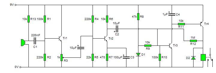

The problem is you need lots of gain and a high input impedance for an electret mic. Here's a simple circuit that will drive a small relay from an electret mic, I haven't tested it but it should work.
Tr1 is an emitter follower which has a gain of 1 and a high input impedance.
Tr2 is a common emitter amplifier which has lots of gain.
Tr3 is a precision rectifier which rejects half of the waveform. D1, R9 and R1 set the base voltage just below Tr3's turn on voltage.
C4 and R11 form a low pass filter which keeps the output switch on in-between troughs.
T4 is another common emitter amplifier which switches the relay.
R12 provides positive feedback which adds hysteresis making the circuit more stable.
R3 alters the sensitivity of the circuit.
It would be easier to build the circuit using ICs such as an op-amp and comparator but I was bored.:D

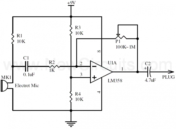

: here in my attached image of circuit can i obtain 5-6Volt output by adjusting the potentiometer???

What do you want the circuit to do?
Do you just want a pre-amplifier or do you want a switch?
That circuit won't work because its input impedance is too low:
  • Configure the op-amp as a non-inverting amplifier which has a high input impedance.
  • Use a decent audio op-amp such as the TL072.
  • Vary the volume using a pot. AC coupled to the mic to avoid noise being generated when it is adjusted.

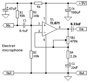

The battery needs a supply bypass capacitor and the 10k resistor feeding power to the mic and the resistors biasing the inpu of the opamp should be de-coupled from the supply like this:
The output is an AC signal 6.5V peak-to-peak into a 10k ohms load.
