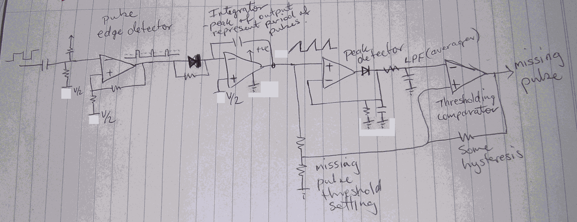

Is there an easy way to make a circuit that will accept a digital square wave that will vary between about 5KHz up to a maximum of 150KHz and have it detect a missing pulse? There would only ever be a single missing pulse, guaranteed by the circuit generating these pulses.
This signal is a clock used by a counter. I want the counter to reset when it gets the missing pulse. I don't want to run two wires to my counter (clock and reset), and would like to get the reset on the same single wire as the clock.
The only other thing I thought of was to have the pulse for the reset to be twice the voltage of the normal "clock" pulses, but then there is the possibility of noise giving a false reset.
