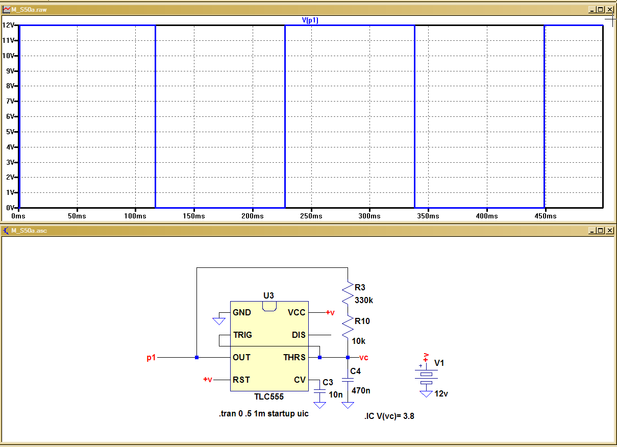

The attached image shows a 555 timer which gives a very close to 50% duty cycle.
I dont follow your other requirement.?
If you had a repeating 120ms trigger into a 100mS Monostable you would get close to 100mS high 20mSec low, providing it was a fast/narrow trigger pulse.

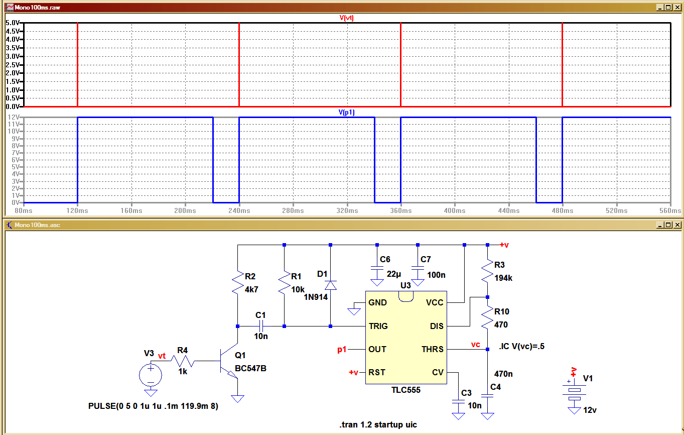

EDIT:
The 2nd image is what I 'think' you are asking.;)

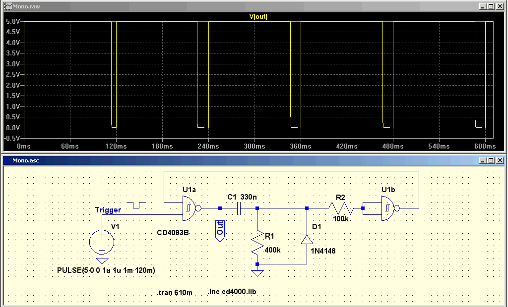

How about this? The diode allows rapid re-charge of the cap. The monstable period is ~0.7*R1*C1.
