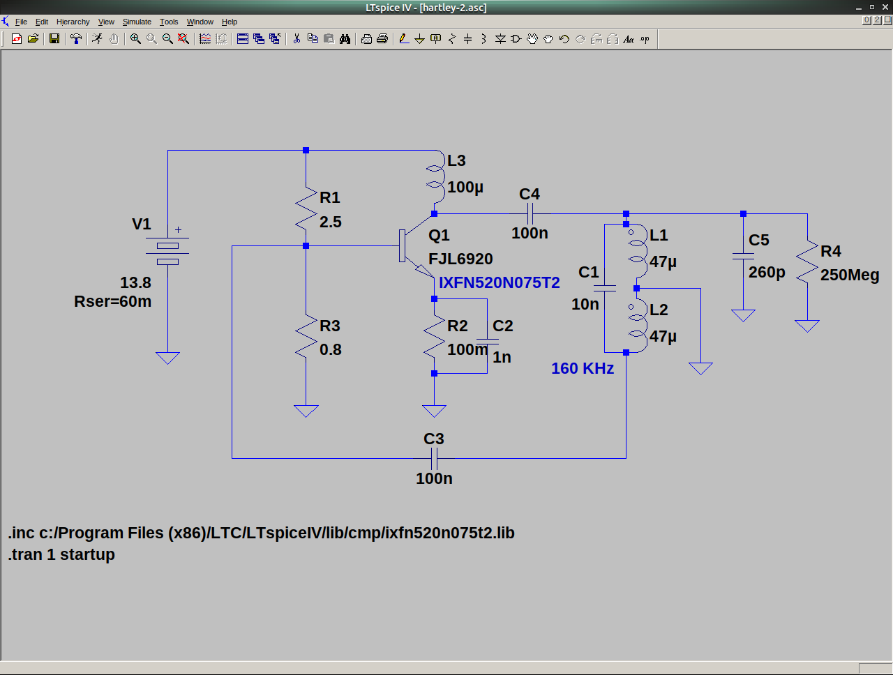

I am having trouble designing a Hartley oscillator using Mosfet's because Mosfet's a new to me still. All I know is that Q/I= switching time. I had to change the extension on the file, EOL won't take an sp3 file?
  • ixfn520n075t2.sub
You have no gate bias control, it's connected to power??

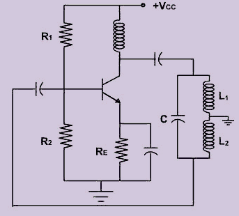

This is a Hartley oscillator in its commonest form; the only real change to substitute a a FET is to adjust the bias divider to give and appropriate standing current with the new device.
The coupling caps isolate the DC from the inductor and the DC levels & standing current are totally controllable:
Or with a choke in place of the resistor, as the output load:
Try moving the inductor coupling cap to the top end (or output) instead of the bottom end, then feed the bias at the inductor centre tap?
You should then hopefully be able to use a large decoupling cap on that to handle the AC ripple and much higher value divider resistors?

Yes, that was discussed and is step two when I give-up on a monolithic design.
I'll give the one on the left a try. I had an earlier attempt like that only I was missing the cap on the center tap.
The value of the centre tap. cap. C2 is not critical as it is creating a shunt to ground, but just cannot be too much smaller than the main feedback resonant cap. But it is essential to have one to create the phase shift. C2 can be almost any value, say 100 pf to 100 nF but not 0 pF. fo=1/(2pi{(L1+L2)C}^.5)
The phase shift is 0 deg without the Cap. to ground.
