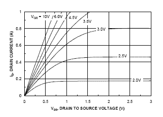

I almost always use FETs - probably because that was what we used in school. If you need to use them in low voltage applications, check the threshold voltage (voltage at which the FET turns on). My favorite NFET for 3V applications is the BSS138 - cheap, and with a very low threshold voltage.
Help me out with this "fully turned on" business of FET's, as I came across this the other day. What indicates a fully turned on condition? I haven't done much in the way of power systems.
  • NFET BSS138.pdf
Hmmm.... yesterday we were discussing driving an IRF7201 in triode mode to drive a relay coil, and the subject of "fully on" came up. https://www.electro-tech-online.com/threads/i-need-help-choosing-a-transistor.93432/ I think AG is very knowledgable about these things, and knows what he's talking about, as do you. But I still can't get my head around the concept. BTW, I looked at the Rdson spec for the 7201, and it was specified for both VG=10V and VG=4.5V. Below 20A Drain current, Rdson was around .05Π I think for both inputs. But over ID=20A, there was significant difference. So, I assumed that was the difference between being "fully" on and just "on."
Anyway, there seems to be many ways to define what "on" is. I just need to understand the vocabulary.
If you look at the IRF7201 datasheet again, you'll notice the Rds(on) at 10V == 30mΩ, and 4.5V == 50mΩ.
Being "fully on" just means that you have hit the top(or bottom) side of the Rds(on) curve. That the resistance is about as low as it's going to go, regardless of how much more voltage you apply to the gate. There is no real set point at which this happens, and more of an acceptable point to the application at hand.
The DS shows the gate threshold voltage to be only 1V. That's when the MOSFET starts to turn on and pass current, but at a very high resistance. It's not until the gate hits ~4V that the resistance finally starts hitting an acceptable range.
Figure 6 of the DS is showing that using only 4.5V at the gate will hit a maximum saturation of the drain-source junction due to the field not being large enough for the entire channel to conduct. It's not "fully on" yet for that amount of current. If you wanted to pass more current, you would have to drive it with a higher gate voltage.
Actually, I'm looking at an International Rectifier IRF7201 datasheet, and it appears that around Id=5A, Rds~=.025 @ 10V and ~=.035 @ 4.5V. That seems like such a small difference. However, as Id reaches around 20A, the curve for Vg=4.5V appears to spike up exponentially, while the 10V curve remains flat. IRF7201 pdf, IRF7201 description, IRF7201 datasheets, IRF7201 view ::: ALLDATASHEET :::
Would it be corret to say that under 20A, the device is "fully on" with VG=4.5V, but not at Id>20A?
