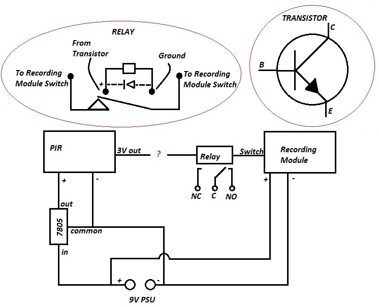

I would likely use a 7805 5 volt regulator to get my 5 volts (from 9 volts) to power the PIR sensor. I would then have the PIR sensor output drive a transistor like a cheap everyday 2N2222 and use the transistor to drive the relay used to trigger the audio module.
There are other ways to go about it and likely someone else has some thoughts but I would likely approach it as I mentioned.

You may have a problem here in that the recording module actually needs 9 volts. Since the module has a 5 volt regulator depending on the regulator used you would need to supply a few volts greater than 5 volts. For example if we apply 5 volts to a regulator like the 7805 we get nothing out, we need to apply at least 7 volts before the regulator will work. Just something to consider.

Yes, it is called the "Dropout Voltage"
All linear regulators require an input voltage at least some minimum amount higher than the desired output voltage. That minimum amount is called the drop-out voltage. For example, a common regulator such as the 7805 has an output voltage of 5V, but can only maintain this if the input voltage remains above about 7V. Its drop-out voltage is therefore 7V - 5V = 2V. When the supply voltage is less than about 2V above the desired output voltage, as is the case in low-voltage microprocessor power supplies, so-called low dropout regulators (LDOs) must be used.
The above taken from here.
I just used the LM7805 as an example where 7 volts is required to have it work. There are linear regulators that have lower dropout voltages but all have a dropout voltage.

I spent all weekend reading about the transistor. This is what I have but it just doesn't seem right. Porbably because I still don't understand the jargon or because I'm wrong. Either way, thanks for the help.
We have a Base, a Collector, and an Emittor. My PIR would output to the Emittor. Collector would output to the Relay. I have no clue what Base would do, Ground maybe?
Thanks in advance.
So what've I got right and wrong here. Obviously "?" is not a standard electronics symbol. I know the transistor goes there but not sure how.
