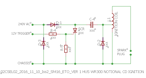

Below is the schematic of post #22 above, turned into English.
(there may be some some additional electronics to alter the spark timing in relation to revs)
If this is in fact what the Hus WR300 CDI comprises, a charging and trigger circuit will be reasonably straight forward.
ERRATA
(1) 240V should read 230V

Hi spec,
Like me you have re drawn the schematic to make it easier to understand. I think you have put one diode in the wrong place. I thing the bottom end of r5 should go straight to the chassis and the diode should go between chassis (+) and the end of the capacotor connected to the coil. I have not worked out what D3 does. If there was a capacitor in series with the AC input the circuit would be a voltage doubler.
Les.
Yes, I noticed. How some people can work/understand the convoluted schematics you sometimes see around is beyond me. They must be extremely clever.:D I have studied my automobile (car to us) wiring diagrams and, unless automobiles use a special type of electricity, they are beyond me.
I think you have put one diode in the wrong place. I thing the bottom end of r5 should go straight to the chassis and the diode should go between chassis (+) and the end of the capacitor connected to the coil.
Oh yes. It was just a test. I wanted to see how long you would take to spot it!:p (I don't think) I will correct the schematic- thanks.
UPDATE: No not sure about D3 either. As shown the diode will short the 230V for negative excursions which, in conjunction with the voltage generator coil. may have a voltage multiplying effect.

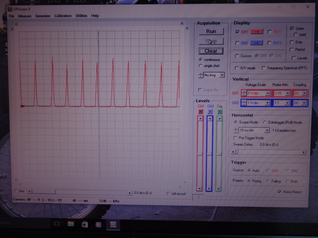

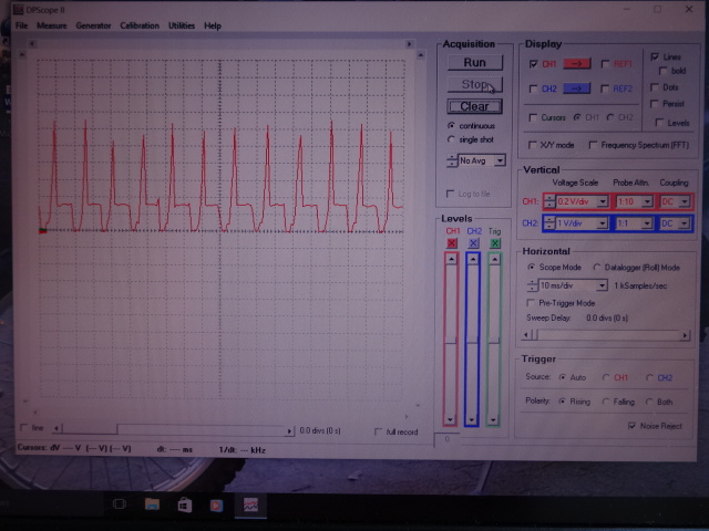

G'day Spec, Les, just back from a work tour, and checked the timing tonight, with a timing light connected. Yes, correct Spec, at the minimum rpm it would idle at, it fires at 18 degrees (plus or minus one) before TDC, and revving to as high as I am game to take it to in neutral, ie blipping the throttle hard, it moves to about 8 degrees (give or take one) So yes, it has decreasing advance with rpm, as many modern two stroke have.
Now, I think I might be wise to ask you guys for advice on using an oscilliscope / probes correctly, to make sure I am not giving false info.
The setting you see on that screen grab are what was actually set on the probes etc.
Les, I take on board what you mentioned about high voltages and scope probes.
I assume to use a voltage divider, I would use two resistors in series, one very high value, one lower, connected between the point I want to measure and ground. The resistor values should be in a ratio to drop the expected voltage at the junction between them to perhaps a hundred or so, then connect the scope probe to that junction. The only problem I see, is that the trigger coil is not connected to ground, at least outside the CDI unti itself.
When I took the screen shot I provided, I did connect the scope probe grounds to the engine case.

Hi Max,
For the voltage divider I would suggest the bottom resistor being 1.1 meg and the top resistor being 9 megs. Make the 9 megs up using 9 x 1 meg resistors, (This so the voltage across each individual resister is not enough for it to break down. ) It is probably be easier to make the bottom resistor from 1 meg in series with a 100K. The reason it is not just 1 meg is because it will pe in parallel with the 10 meg input resistance of a divide by 10 scope probe. Looking at your scope traces it looks like the duration of the high voltage pulse is about 1/3 of the full cycle. As you are using the wasted spark system you would need to cut two notches out of the timming disk for the high voltge pulse each with an angle of 60 degrees. This is assuming you are using hall sensors that behave like the ones that I suggested. I have never tried them like this as I have only been interested in counting pulses for tachometers. The data sheet seems to suggest that they will work like this. It will be nice if 250 volts is high enough for your CDI to work as then the inverter that spec has found should be ideal. When the starter/generator is in generator mode does it output DC directly or does it output AC which is rectified ? Does it use permanent magnets or can it's output be controlled like a car alternator ? Will you also have a 12 volt battery on the lighting circuit ?

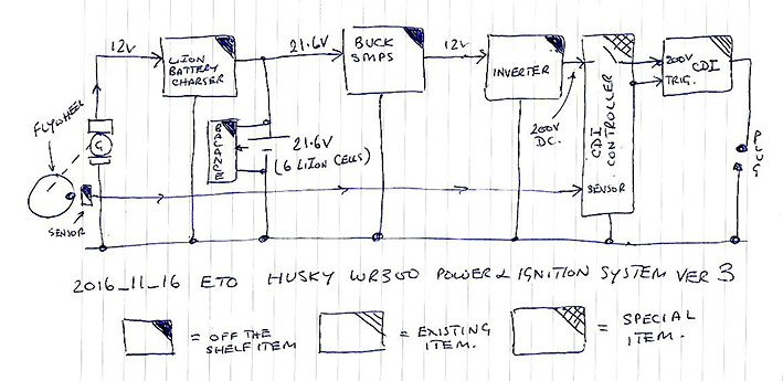

POST ISSUE 2 of 2016_11_16
Hi Max & Les,
Thanks for clarifying the points above in post #31 Max.
In view of what Max says, below is how I now see the overall block diagram of the Husky WR300 power and ignition system. It does look complex but most of the items are off-the-shelf, relatively compact, and low cost.
spec

HI Max,
Sorry to be a pest, but I would just like to confirm the battery & starter/generator arrangements on the WR300.
(1) There is a combined starter/generator rather than a separate starter and generator?
(2) The same connections on the starter/generator are used for both starting and generating functions?
(3) There is one LiPo battery pack, comprising six LiPo cells connected in series to give 6 * 3.6V = 21.6V nominal? The battery pack voltage may be 6 * 3.4V for Lipo, as opposed to standard LiIon batteries, but that does not matter.
(4) When starting the WR300, the LiPo battery pack is connected to the starter/generator?

Les, "When the starter/generator is in generator mode does it output DC directly or does it output AC which is rectified ? Does it use permanent magnets or can it's output be controlled like a car alternator ? Will you also have a 12 volt battery on the lighting circuit ?"
It is a permanent magnet, star connected, 3 phase generator, so no field control. The measurements I took of it running in the lathe gave an output of 12.18 v across 2 phases at 1053 rpm.
The single phase will be enough as it has reasonably heavy windings, which will be rectified and shunt regulated to maintain around 12 volts. No other battery will be used, the original bike does not use a battery.
Spec; "I would just like to confirm the battery & starter/generator arrangements on the WR300".
(1) There is a combined starter/generator rather than a separate starter and generator? Yes, new unit is a combined starter/generator, my own construction.
(2) The same connections on the starter/generator are used for both starting and generating functions? If you mean connections to the windings, yes. However, during either of the start or gen functions, the windings will need to be switched independently to either the starter controller, or the rectifier/regulator.
This is how I see the process:
To start, battery will connect to the windings via the start controller, at/after engine start, dis-connected.
As the start circuit dis-connects, the windings will connect to the rectifier/regulator for engine running, at the same time, the battery charger will connect to the battery.
(4) When starting the WR300, the LiPo battery pack is connected to the starter/generator? Yes, via a controller.
(5) Can you give details of the battery pack: 1 pack with 6 cells in series (6S) 5000 mAh. The nominal voltage of this battery pack is 22.2 volts, ie; 6 x 3.7 v
(5.1) Is the battery pack off-the-shelf or did you make it from standard cells ? Off the shelf, HRB-XF, 5000 mAh
(5.2) Is the battery pack protected. Not that I can establish. I will monitor it very carefully in the early stages of operation to ascertain how it performs. The charger will have individual cell management and the battery has individual cell monitoring facility.
This provokes a question of how will the CDI be supplied in the event the battery has to be switched off for any reason ?
I guess the SMPS could be manually connected directly to the gen output, before the engine is started, if the starter circuit is not activated, then kick start the engine as normal.
(5.3) Does the battery pack have a charging balancer built-in? Not a balancer, but connections for the charger to keep it balanced.
(5.4) What is the nominal voltage of the battery pack? It will vary from 6 * 3.4V to 6 * 3.6V depending on the exact battery chemistry. These type of LiPo are recommended to be operated between 3.0v minimum under load, (3.7v static) to a maximum charge of 4.2v.

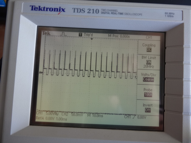

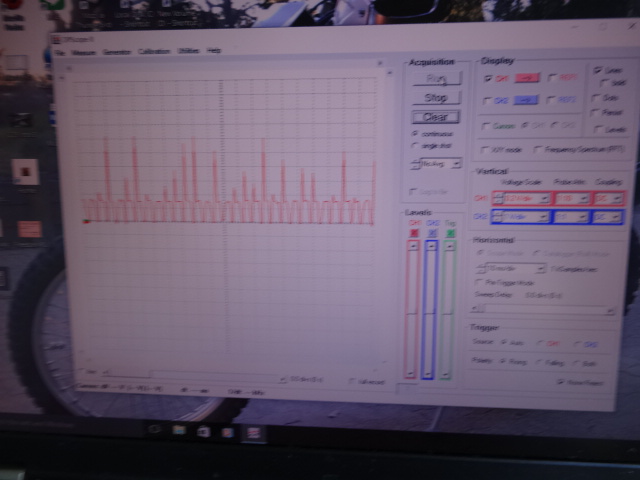

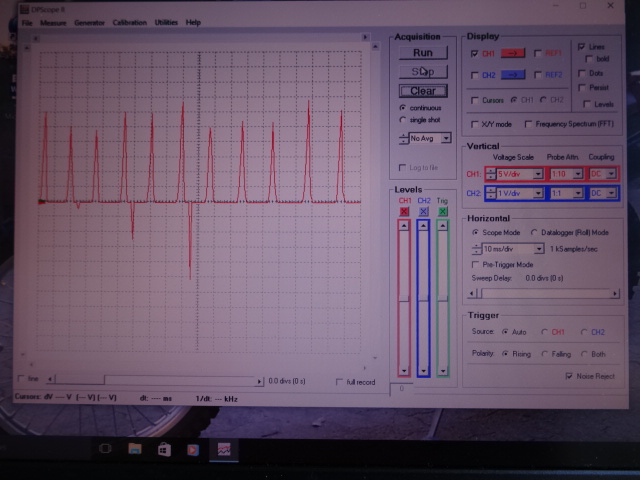

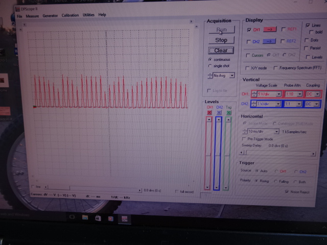

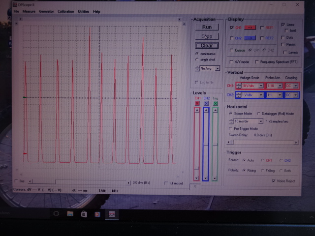

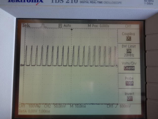

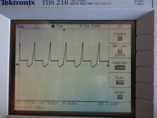

Hmm, it uploaded before I was ready. Here are the latest measurements, taken with the engine running, a Voltage divider of 7 x 1.2M ohm + 1 x 1.2Mohm + 1x100K resistors in series. This was connected to each of the two leads in turn from the charge coil to the CDI, ( one each end of the coil), the other end to earth.
So like this....CDI Input lead, 1.2M, 1.2M, 1.2M, 1.2M, 1.2M, 1.2M, 1.2M, Scope probe, 1.2M, 100K earth.
Hope that makes sense.
I used both the USB and stand alone Tektronix scopes to hopefully remove any doubt about voltages produced.
All readings were with the probes set to 1:10.
Pic 1, eg; Lead A , at idle, USB scope
Pic 2 Lead A, with revs, USB scope. (Sorry about pic qual. but no change in voltage, only frequency.)
Pic 3 Lead A, idle, Tek scope
Pic 4 Lead A with revs, Tek scope
Pic 5 Lead B, at idle, USB scope
Pic 6 Lead B revs, USB scope
Pic 7 Lead B at idle, Tek scope
Pic 8 Lead B with revs, Tek scope
DSC04031.JPG DSC04032.JPG DSC04033.JPG DSC04034.JPG DSC04035.JPG DSC04036.JPG DSC04037.JPG DSC04038.JPG DSC04040.JPG DSC04041.JPG
Pic 9 Lead B at idle, but using a different brand probe at 1:10 also
Pic 10 Lead B at idle, probe of #9 above, but at 1:1 (note I forgot to change the scope setting to 1:1 )
The settings on both scopes were as you see them in the pics.
After uploading all those, I realized I'm probably labouring the point here somewhat. But I also wanted to give as clear a picture of what is going on as I could.
I was quite surprised to see that the voltages do not increase with revs, only the frequency as expected.
(6) What maximum current does the starter/generator take when starting? I have not been able to get an accurate reading of this yet, but I know it is just north of about 30 ish amps. My 30A benchtop SMPS will sometimes turn over the engine correctly, and sometimes not, with the red overload light on.
Many thanks for you helpful and comprehensive reply to my pesky questions Max.:cool:
If more posters were as forthcoming as you, it would be a great help and would save us a much sweat trying to find out what exactly the OP wants.
I do not see any insurmountable problems from what you say.
I do suspect, as anticipated, that the starting current will be high though.

Please correct me if I am wrong, but the measured voltage will be:
Screen trace vertical value in divisions, x Front Panel Volts/Division setting, x probe ratio (1:1, 1:10, 1:100) as the case maybe, x any voltage divider value applied between the circuit point of interest and the scope probe.
If we refer to Post #37, Pics 5 and 9, the trace reaches 6 divisions, the V/div is 5.0, probe setting is 1:10, and the voltage divider is reducing the circuit point of interest to 13.4% of circuit voltage. (7x1.2MOhms) + (1.2MOhms+100KOhms) 6 x 5 x 10 = 300 being 13.4% of the circuit voltage gives approx 2,200 volts.
Referring to Post #37, Pic 1, we see the trace reaches 6 divisions, the V/Div setting is 0.2 V/Div, setting on the probe is 1:10, and the voltage divider is dropping the voltage at the circuit to 13.4% of circuit voltage. . My maths give about 90 volts for that wire. It is the other end of the same coil, so this voltage I think must be being held low by being loaded.
Hmm, this confuses the issue, Pic 10 shows what happens to the trace when the switch on the probe itself is set to 1:1. So say 15 Divs, x 10 x 1 (probe ratio)= 13.4% of circuit.....1,100 ish volts, half the previous readings. Can anyone see if/where I might be going wrong ?
These readings are taken as the engine itself is running.
"Is it the vots per division at the input socket on the scope or is it the actual votage befor the probe division ?" This Volts/Div is at the input to the scope, not counting the probe division.
I will have to wait until I'm home to re-confirm the Probe Attenuation setting and how/if that changes the trace on the screen.
I also just realized after seeing the pics I posted of the Tek scope, I had the Probe setting at 1:100 on the scope. I was however, using the probes themselves set at 1:10.
I hope that has cleared up a few things, and not created more confusion.
