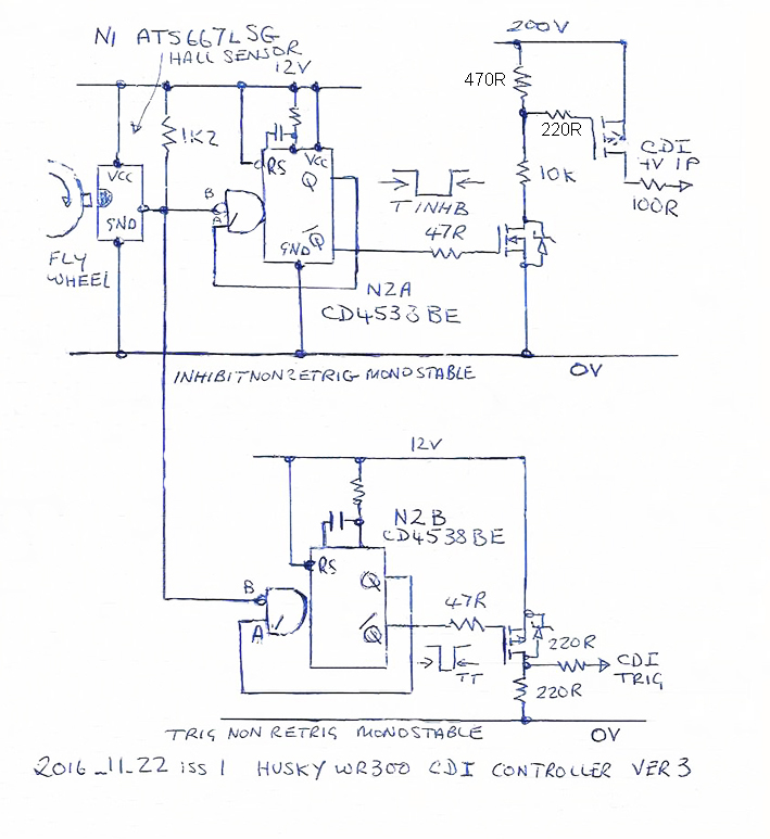

Hi Max and Les,
below is a sketch for a suggested CDI control circuit (every time I start putting it in EAGLE something happens and I get distracted so here it is in the raw).:) The circuit uses the Hall sensor recommended by Les.
spec
DATASHEETS
(1) **broken link removed**
(2) https://www.mouser.com/ds/2/149/cd4538bc-294672.pdf
CIRCUIT DESCRIPTION
(1) When the hall effect sensor detects a gap in the flywheel (don't worry about the practical aspects of this for the time being), the hall effect sensor outputs a negative pulse.
(2) The negative pulse form the hall effect sensor triggers two monostable timers, N2A and N2B.
(3) When the monostable timers receive a negative input pulse they immediately produce a positive level (12V) at their Q outputs and a negative level (0V) at their /Q outputs.
(4) The monostable timers will maintain these levels for a time defined by the resistor and capacitor shown at the top of each monostable timer.
(5) Once this time is reached the Q output will return to 0V and the /Q output will return to 12V.
(6) The monostable timers will then be ready to receive another negative trigger pulse from the hall effect sensor.
(7) The lower monostable timer /Q output connects to an NMOSFET which provides a high current negative pulse to trigger the CDI SCR and generate the spark.
(8) The upper monostable timer /Q output also connects to the gate of an NMOSFET which in turn connects to the gate of a PMOSFET.
(9) The PMOSFET acts like a switch and turns off the 200V supply to the CDI to prevent SCR latching.
(10) The period of N2A is longer than N2B to give sufficient time for the CDI to turn off before the 200V is applied again to the CDI.
(11) The 200V is produced by a standard step up switch mode converter which is powere from the battery and/or the generator.
(12) The 200V inverter runs continuously.
And that is all there is to it.:)

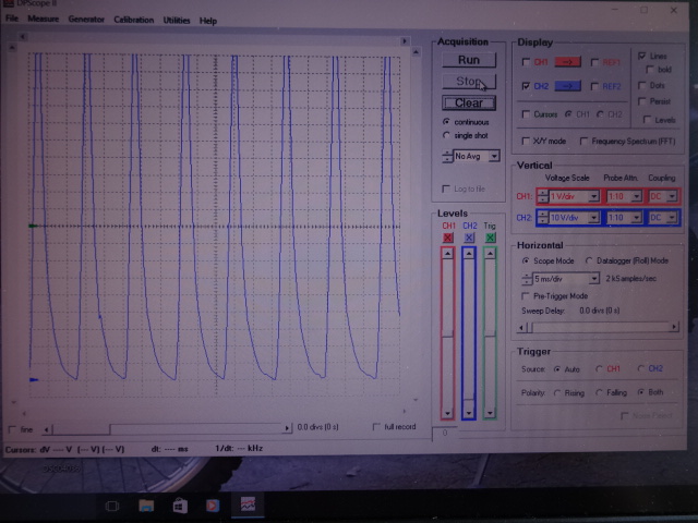

G'day Gents, Thank you for the sketch above Spec. I can't say I understand its operation yet, guess I need more study.
While away on the other side of the country last week, I visited a well known professional motorcycle electrics fellow I know.
I can now confirm some information.
He confirmed what Les has been saying, that the output of the Charge/Trigger coil would be around 3oo ish volts. He suggested I must be picking up some kind of stray field, to measure +2000 volts.
When I re-measured using his method, (at the kill switch) I get greatly reduced voltages. (makes more sense)
I also re-measured using my loom breakout connection, (without voltage divider) but this time routed the wires much further away from the High Tension spark plug lead, and I obtained similar readings as at the kill switch.
The positive 12.8 volts peak is on the charge/trigger wire and the 278v on the other wire to the CDI. These measurements were taken with the engine running at a bit over 2,000 rpm.

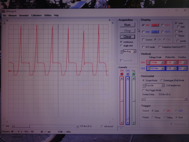

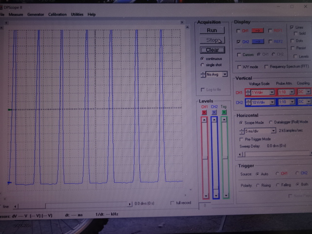

He showed me the circuit diagram of the inside of the CDI and confirmed only one of the wires does both the charging (North Pole/Pos. cycle) and the triggering (South Pole/Neg. cycle). This is the wire showing about 11v in the first attached pic of traces, where the voltage first has a positive peak, capacitor charging, then goes a little negative as the scr is triggered.
The second pic is from the other end of the charge/trigger coil, into the cdi.
The third pic is at the Kill switch.
To answer a previous question Les asked about which voltage does my scope display. I did some checking and the answer is the voltage of the circuit the probe touches, when the divide ratio on the scope panel is set to correspond with the probe ratio. ie; 1:1, 10:1 etc.
In the below pics, the panel and probe settings were at 10:1.
So hopefully this makes things a little easier, not needing such high voltages.

G'day Spec, Am I asking too much to ask for an explanation of how your circuit functions and what the various components are ?
Hi Max,
Nice to see you back on ETO.
Hope you had a good Xmas and all the best for 2017.
An explanation of the schematic of post #46 would be no problem.:)
spec
Hi again Max,
Circuit description now added to post #46.
If you have any questions just fire away.
spec
