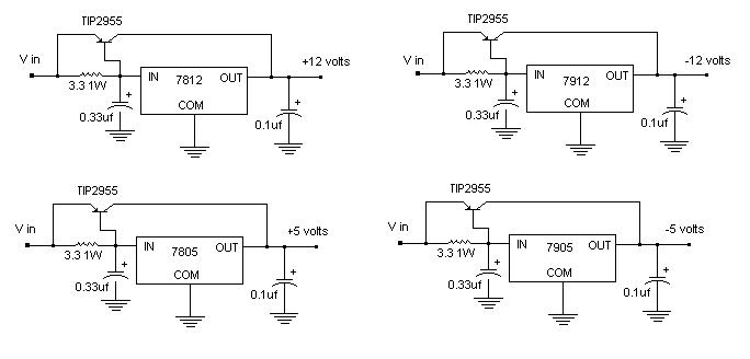

Hiya Guys,
The following pic I got from a circuit mag, the description says it can be used in all the 78xx and the 79xx voltage regulators and can pass around 4 amps of current from a 1 amp regulator. If I'm way off base please let me know as I'm in the process of designing it on some veroboard. As far as the 3.3 volts go can anyone suggest a good regulator chip to use. I'd rather use a decidated chip instead of a lm317.
Cheers Bryan1 :D

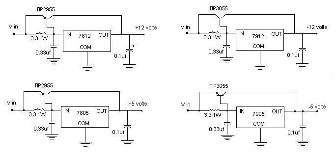

1. Those capacitors should not be polarized units (I forgot to remove the plus sign on one of them).
2. You need NPN current-boost transistors for the negative supplies.
3. Vin for each positive supply needs to be at least 4 volts more positive than its respective output. Vin for each negative supply needs to be at least 4 volts more negative than its respective output. You cannot use the same unregulated voltage for all four supplies.
4. Watch out for excessive power dissipation in the regulators and the transistors. You will need heat sinks.

Hi Ron,
Eh mate thanks for redoing the negative circuit, and on thinking what you said about not being able to use the same supply I should of realized that at the start. But I do have 2 seperate 24 volt battery banks as 1 is a nicad setup and the other is leadacid. So I reckon if I use the seperate banks for the positive and negative rails I might stand a chance of getting this to work. The whole point of doing this by the way all started on me wanting a mp3 player for the shed but the idea of running a desktop will give me the power to interface other stuff aswell. Well tomorrow I'm off to work in the desert for 3 weeks so I'll have plenty of time to work things out but thanks again.
Cheers Bryan :D

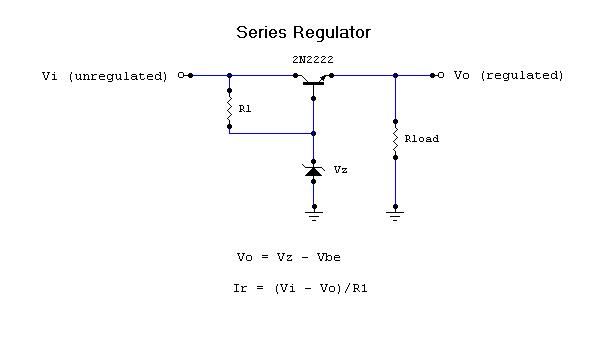

for the 3.3 volts. used the circuit of lm317.
you can also use a series regulator circuit. a zener diode and transistor.
