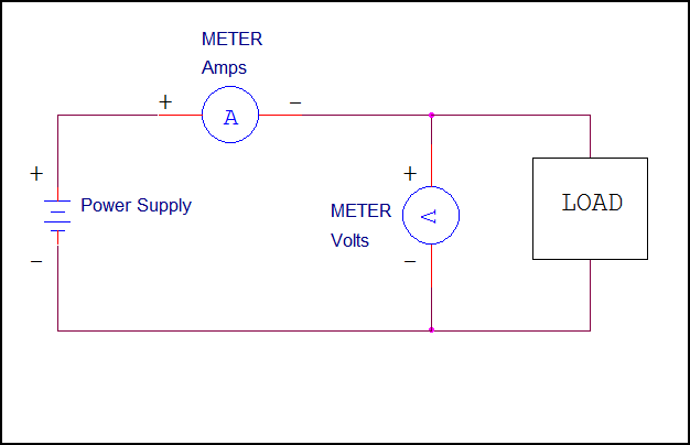

A circuit rated for 5 volts @ .3 amp will draw just that. It matters not what the supply is capable of. The common example is a car's battery. The battery (supply) is capable of delivering hundreds of amps. However, the accessories on the car's system only draw the current they need at their rated voltage.
When using a voltmeter to measure voltage it is placed across the load, when measuring current with a current meter it is placed in series with the load. Note how the ammeter and voltmeter are configured in the attached illustration.
Ron
