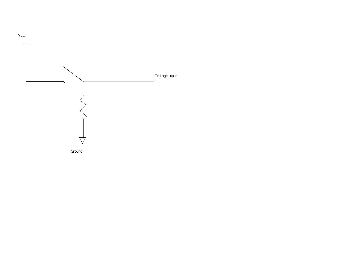

this is my schematic. thanks for the tips guys. the problem i have is ive been using a push button and so when pressed this gives me a true input but when the button isnt pressed obviously the input is left floating. i need to purchase some spdt switches. in doing so ill no longer have floating inputs as i will connect one pole to VCC and the other to ground. so i can switch between both stated without causing floating inputs.
That's neither necessary, not does it necessarily solve your problem. All you need is a resistor that pulls the level to the opposite when the switch is not being pressed. For example, if the switch connects to ground when pressed, use a 10K resistor pullup (or pulldown if the switch connects +VCC). That's all you need.
this is the situation, when i press the button i want this to send a value of one into the circuit and circuit will output wll respond according to how i have built it to give me a turned on led. the problem is when its not pressed the inputs are floating. so you are suggsting that i insert a resistor? where?
Connect between your switch and ground, like the diagram below. When closed, the switch applies VCC to your input. When open, a ground is applied through the resistor.

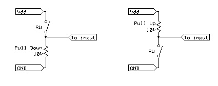

Here is the way to hook up switches with pull up/down. The resistor is there to provide a valid logic level when the switch is open.
Also remember that since switches are mechanical, their behavior is not completely "clean" during the switch. Their output might oscillate (or "bounce") rapidly between 0 and 1 a few times before settling. Depending on what you do with the output of your circuit, that may be a problem.
nor does it necessarily solve your problem
BrownOut is referring to the fact that during the switch of an SPDT switch, there is an intermediate state where the signal is floating. Once again, depending on what you do with the output of your circuit, that may still be a problem.
