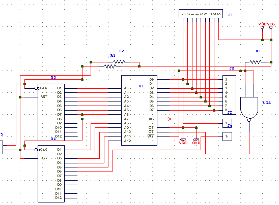

Take a look at this circuit.
The 1's in the boxes are output connections. the bottom "1", if it is logic high indicates that the last address has passed.
The top "1" is a check bit. It makes sure that the LSB is correct.
Connection "1" on the far left activates the address clock upon reaching a logic low.
Connection "2" on the far left resets the address clock upon reaching a logic high.
The numbers 1 through 8 (not sequentially) going downwards on the right hand side indicate the data pins on the parallel port.
Here's the problem. As soon as the circuit is turned on with 5VDC, and the parallel port is plugged in, the ROM chip immediately warms up.
Every time the chip warms up, the programming normally fails.
The chip that warms up is the 28C64.
The other chips are the 74HC00 NAND, and 2 4040's.
The other resistors are 6.2K.
Should I remove a resistor or increase a resistor?
I forgot to upload my circuit, so here it is.

Troubleshoot the lines going to the rom chip. Obviously, it sees something it doesnt like. Plug it all in and turn on 5V but no rom. Look at lines that would go to rom anything nasty / unusual?
You are using external 5V supply? I _think_ the parallel port signals are referenced internal to PC. Make sure you do not have some ground loop problem connecting your external ground to the port. I think it is popular to optically isolate parallel port lines.
You know what I forgot to include, an input connection on my schematic to the WE pin. :lol:
I fixed it.
The circuit is exactly the same, except for the following changes:
#1. I removed the 4.7K resistor bus network.
#2. I removed the 6.2K resistor.
As soon as the 6.2K resistor is removed, the program is stored correctly!

I think the 28C64 has an internal resistor to its mode pins (WE', CE', and OE')
I might not realized that I had 3 resistors in parallel when I used that 6.2K to the WE' pin. (6.2K, 4.7K in the control pin of the parallel port, and a resistor attached to the WE' pin?) Of course, I may be false on this statement, but when chips heat up, I know it is because it is receiving a voltage or current or power that is too high.
Your circuit doesn't have a supply bypass capacitor so it is probably oscillating at a very high frequency which is causing it to heat up.
Also, the WE-not is made high by the resistor R3, and since CE-not and OE-not are low then the data pins are outputs, as Nigel told you.
If the bus has signals on it then the outputs of this EEprom are fighting with the bus signals. Fighting outputs make a lot of heat.
As Nigel told you, you had outputs connected to outputs.
Your schematic doesn't have a 6.2k resistor. Maybe R3 is the 6.2k resistor that makes WE-not always high, and makes OE-not always low, so the EEprom is making its data pins outputs.
It also doesn't have a way to make WE-not low and OE-not high (through the inverter?) so the chip can be programmed.
