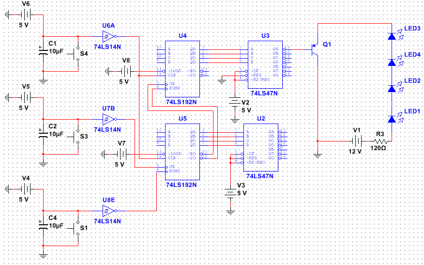

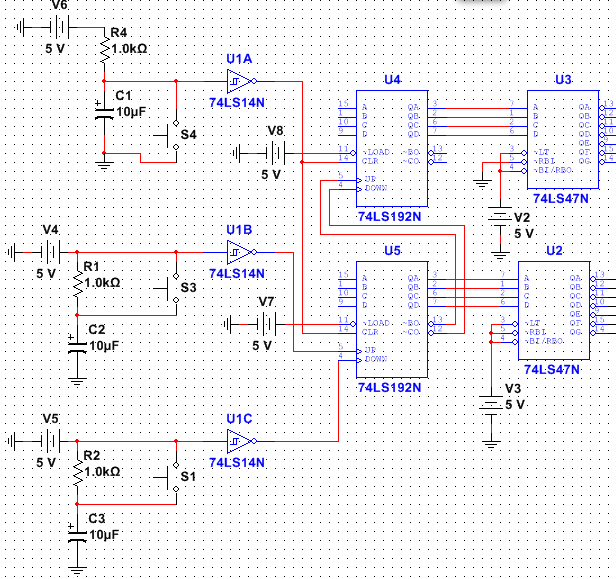

Your cap values are still way too low. Make them 10uF. You can also eliminate R1, R2 and R18 because the 74LS14 has internal 20k pull-up resistors. You will then have a debounce time-constant of 200ms, resulting in the '14 input being held below the upper Schmitt threshold for ~80ms, considerably greater than likely switch bounce duration.
:confused: I've no idea what those voltages relate to, but the Vf of a red LED is typically in the range 1.8V-2V. You still haven't said which LEDs you will be using. White LEDs, for example, have a typical Vf > 3V. For a 12V supply, Vf = 2V and 4 LEDs in series the current through them will be ~33mA, which is excessive if typical red LEDs (rated 30mA max) are going to be used.
To blank a leading zero.
Not understood.
Hi Alec, I made the alterations as you mentioned to the design. I thought I already changed the Cap Values, but I may have loaded a previous version or not have saved it. scoreboard_design08.png

I agree with BB. The gate inputs should be connected to the caps and switches only (unless you want to include a respective 100Ω resistor in series with each cap to reduce the current through the switch to prolong the switch life).

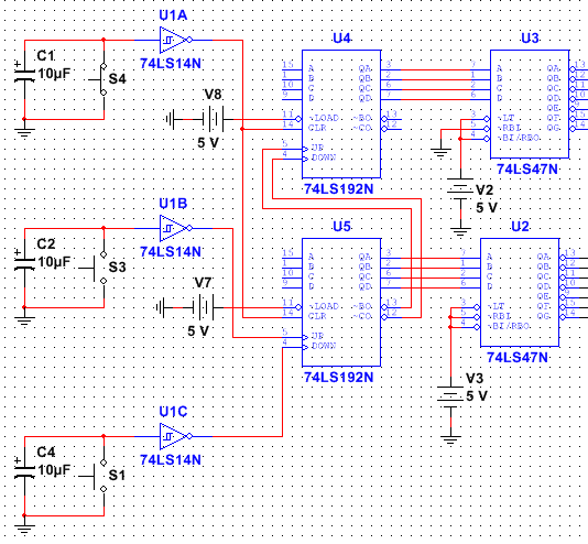

The first circuit will work; the second won't.

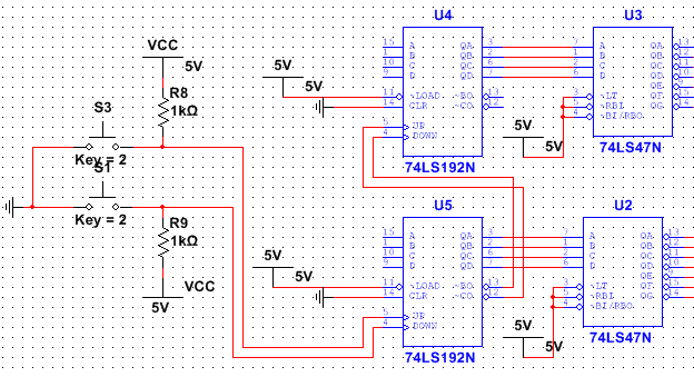

I just saw something similar to what I am doing and found a schematic, which uses a button system like this:
Is this better than the one we devised? It doesn't include the 74LS14N.
It doesn't have the switch debouncing. Get yourself a plug type breadboard and experiment a little bit. There is allot more to it than a piece of a schematic;
Voltage regulation, bypass caps, wire length, construction practices
Even with us seasoned hobby builders there are unforeseen bugs.
Let us know how it works out.
