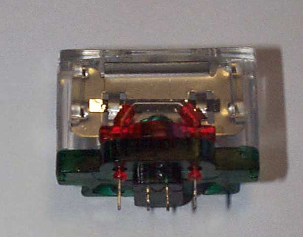

New photo
Here's a new photo for you sorry about the quality but you should be able to tell what it is (if you know:)

Not sure what that is but does it emit or receive light?
No,
No moving parts, the two pins that are close together are the source and drain of a MOSFET.
eyeballing the configuration, I'd like to say something like a kelvin current sense resistor, but the mosfet clue completetly stumps me.
No, It's not a resistor or switch.
Quick clue the narrow metal strip just behind the wire loop has an atomic mas of 241.
Is it an Americium element sensor for a fire/smoke alarm or a similar detector?
If so, Americium is a man-made radioactive element created in nuclear reactors from plutonium. It's most important isotope is Americium-241 and is popularly used in the ionization chamber of most smoke detectors. It does emit both alpha particles and low level gamma radiation. Americium is abundant on site, after nuclear weapons detonations. Americium-241 is a long-lived radionuclide and has a half-life of 432 years!!!
