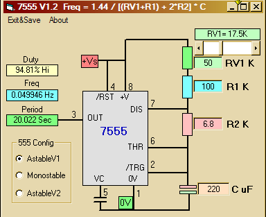

id use a 555 timer circuit, with a counter chip, then load it to a transistor switch

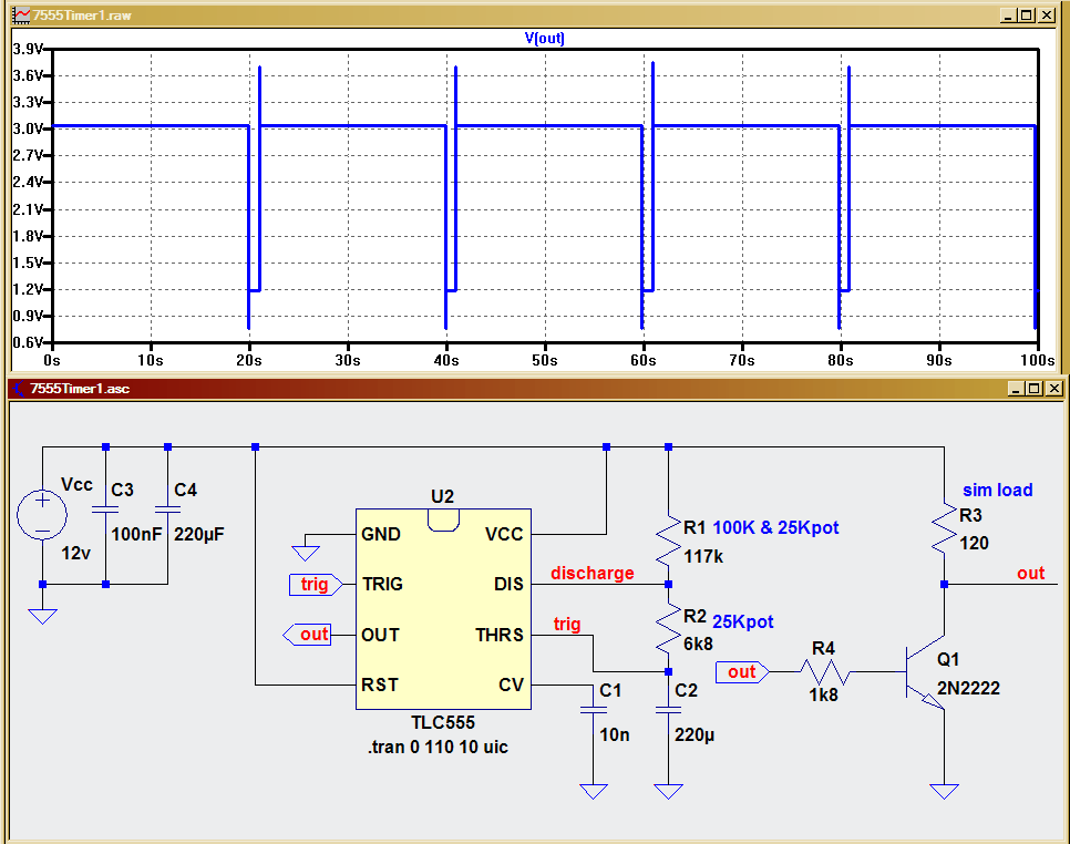

A single 7555 timer driving a 2N2222 would do the job.
Make R2K a 15Kpot so that you can vary the ON and OFF periods.
This an option, use a 12Vdc 500mA wall wart as the power supply.

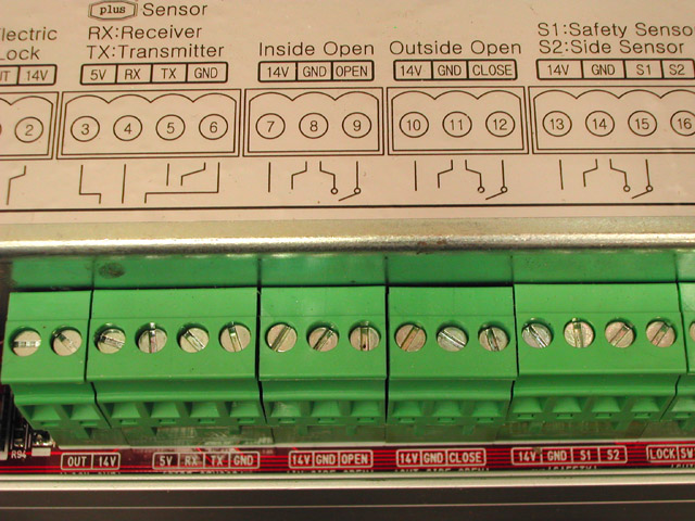

I'm not sure how to answer that Eric. What I did was use my meter to measure the current going through the switch at terminals 11 & 12 (see image). The meter became the switch for this measurement. I saw 50-70mA doing this test.
I can use 11 & 12 or 8 & 9 for the test. They are programmed to act differently but that would not have any effect on my cycle test.
Not much info in the manual on these terminal blocks;
Sorry I don't have a better answer. I'm a mechanical guy not an electronics guy..........Bill

The labels on the terminals of the controller indicated that the contacts 8/9 11/12 are expecting a contact closure, either a switch or relay contacts.
The 100mA you measured is the current that would flow thru the contacts.
The easy way is to use a 12V relay driven by the 555/transistor and use the contacts to close 8/9 or 11/12
If you measure the voltage on pin 7 to GND and pin 10 to gnd you should get 14V, check the manual for the controller, the +14V terminal may be able supply enough current for the 555/transistor/relay... in that case you dont need an external 12v supply
OK.?

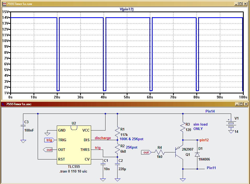

If the low pulse closure has to be the 1 to 2 secs duration and we can use the the14V this option will SINK 100mA.

Yes 8 & 9 and 11 & 12 are looking for switch closure. I was thinking it could be done with a solid state component if there wasn't too much current going through the switch. That's the reason I looked at the current through the switch -- to see if it was possible to avoid the use of a relay. 100mA doesn't sound like much to me but I know nothing. BTW, I'm seeing 4.2VDC across 11 & 12.
I'm getting 13.4V across 7 & 8 but not 10 & 11 (for some reason??). Anyway, it looks like we have 13V available full time at 7 & 8.
>>If the low pulse closure has to be the 1 to 2 secs duration and we can use the the14V this option will SINK 100mA. <<
You lost me here (easy to do, for sure). I can make/break the switch as fast as my finger will move and the controller responds 99% of the time. A short (.5 second to 2 second) closure would be fine and would not interfere with the end of the door cycle which takes 3 seconds on the opening half, longer to close.
Thanks...............Bill

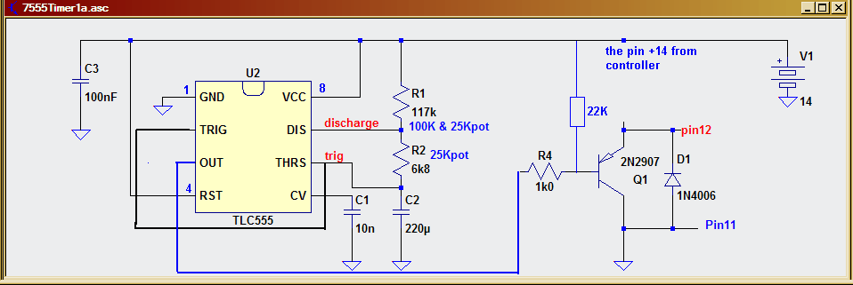

All that part part means that 11 and 12 will be connected together [via the transistor] for about 1 second and open for about 20 seconds.

What would be the trigger is this case? The [TRIG> symbol isn't something I'm used to seeing. Likewise, the <OUT] and [OUT> seem to indicate they are joined but not shown as a connecting line -- is this the way to read it?
R3 is noted as "sim load ONLY". Does that mean it's there to complete the circuit design in the software but in the real world that load would be there from another source?
Sorry for all the newbie questions but I am in fact fairly clueless about this stuff.............Bill

Cleaned up the drawing for you, please ask if in doubt.
Add that 22K.
