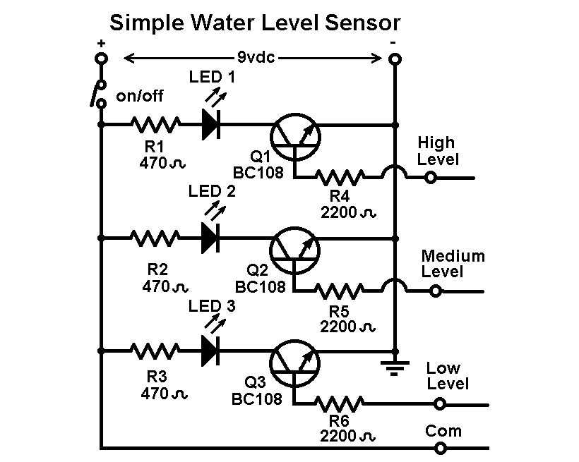

plz give me some circuit/idea about converting the bike petrol measurement in digital for my two wheeler. for measurement of how many litres and resrve litres
How about this Design.
  • digital_fuel_gauge.pdf
LowTech
Automotive fuel tanks have a rehostat in the tank operating at 12 volts, so explosion is apparently not a concern at low current. You could modify an automotive sensor (float and rehostat), and use a digital voltmeter for display.
