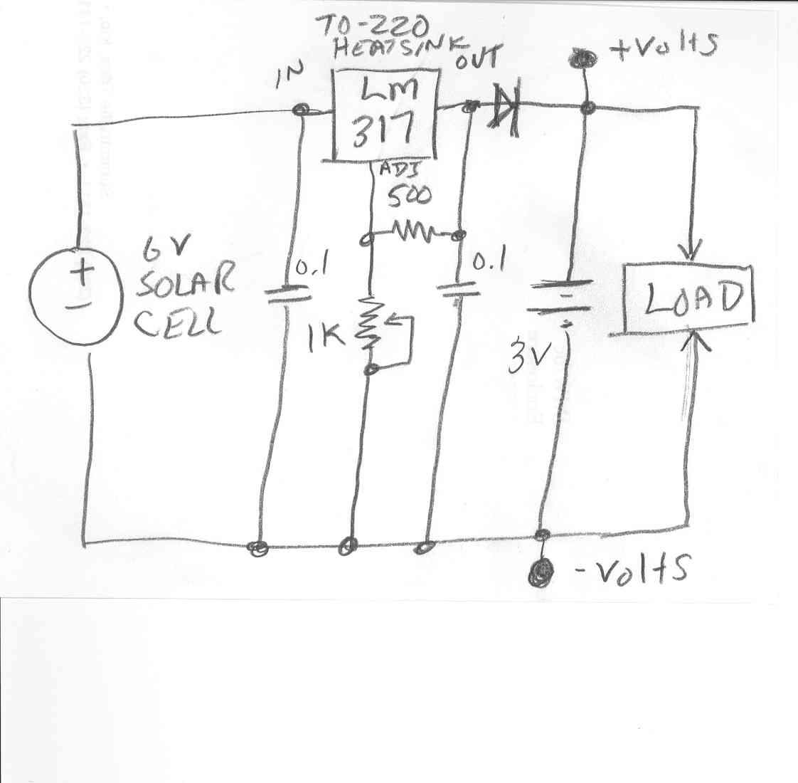

by the way...one end of the battery goes on the device and the other end of the solar cell goes on the device also?

I really doubt that your solar cell can provide enough curent to run the circuit shown. What is the current requirements of your load?
2 AA batteries is 3v, if you connect to the circuit like that through a 1N4148 diode you will get only 2.3v to the circuit. When the batteries are low (say 2.4 volts?) you will only get 1.7v to the circuit.

engtech, You never did specify what TYPE of rechargeable batteries you were using. You stated they are 1.5v each. That sounds more like Akaline Batteries - which are not rechargeble. Recharging a battery (properly) is not always a simple matter of just applying a fixed voltage.
But to satisfy your circuit requirements of ...
1) Run load/device from battery power when solar cell is dark
2) Run load/device from solar cell when sun is shining
3) Charge (NiCd/Lion/NiMh?) battery with excess solar power
You can you this "newnewcircuit" that I modified from Message #21.
You need to...
a) Pick a Type / Chemistry of rechargable battery.
b) Learn what max voltage that battery type needs to charge "properly" without also frying your load/device with too many volts.
c) Adjust the 1K variable resistor to provide that max voltage under full sunlight and fully charged battery.
The circuit max voltage is ~3.75V (load/device limit?) You can increase 1K to 2K if you need more volts from solar cell to "properly" recharge the battery but then you may over stress your load/device. If needed, you could add another LM317 after the battery to regulate output on load/device to 3.0 Volts.
OK ?

Hey Summitville, thanks for replying to my thread, i just wanna get somethin simple done here, i viewed your schematic.
basically i want to do one of the two,
1) the device currently runs on two AA batteries, i want to make it so when the solar panel switches on, i want the battery side to shut off.
or
2) have the batteries charge everytime they go low at a certain voltage point.

The circuit in mesg #21 can be used for Alkaline (regular / non-rechargable) batteries since there is no charging currrent. I think it needs some resistors added to the ADJ terminal (see app notes for LM317). Under Full Sun adjust the LM317 to output, after the diode and at the Device Terminals, for a voltage of ~3.0V. Also, that circuit adds a 0.7 Volt diode drop to the battery source. This voltage drop from 3.0V to 2.3V when running on only battery power may be critical to your Device / Load. You need to find out! The Solar Cell will drive the Device when the Solar Cell's Voltage is higher than the battery's voltage effectively turning the battery off. The two diodes make an OR circuit. Whichever Voltage Source, Solar Cell *OR* Battery, has the higher voltage will drive the Device and the other Source will be "turned off".
The Circuit in mesg #30 is for Rechargable Batteries only - not Alkaline/Regular batteries since there is charging current. This circuit runs as I explained previously. Are the rechargable batteries rated at 1.5 Volts? If not then will 2.4V (2 x 1.2 Volts) vs 3.0 V be an issue with your device?
