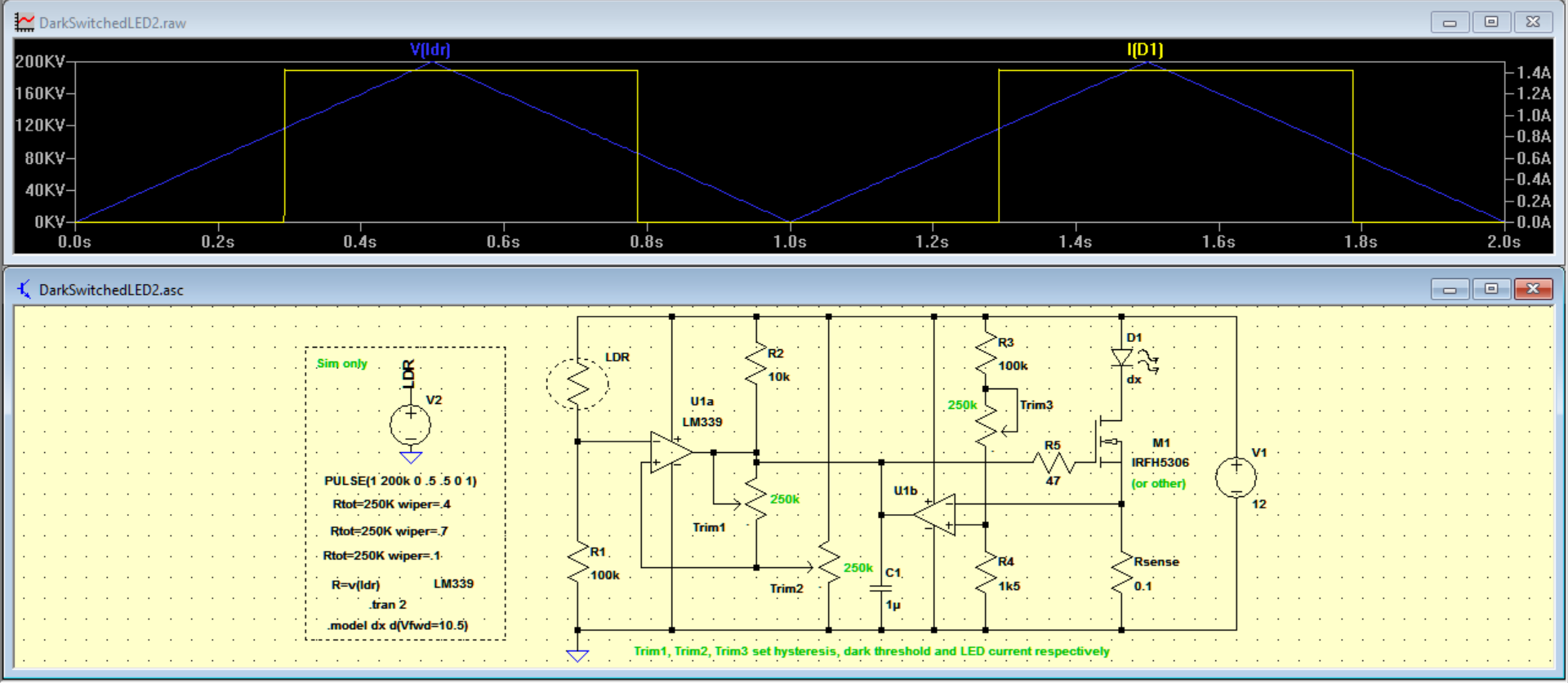

Here's a variation on Les' circuit, using the other half of the 393 (dual comparator IC) instead of the BC337 to provide current regulation, and with hysteresis added to the first comparator so that passing clouds etc don't cause false switching of the light. Trimmers allow adjustment of hysteresis, dark/light threshold and LED current.
The blue graph simulates LDR resistance. For 'kV' read 'kΩ'.
Note that, as with Les's circuit, a small heatsink will probably be needed for the FET (as well as a large heatsink for the LED). A 100uF cap across the supply, as Les shows, would be advisable.

Got few question (1) the circuit show lm339 chip you did not put pins number in the lm339 drawing you just got plus & minus sign in the drawing for the lm339.
(2) your post mention 393 chip which is correct chip lm339 or 393.
(3) Is there replacement for the IRFH5306 chip,the IRFH5306 chip is surface mount chip ,is there replacement to Dip mount chip.
mrel
Look on the datasheet of the IC to see what it is and to see the pin numbers. An LM339 has 4 comparators in it (14 pins case) and an LM393 has only 2 of the same comparators (8 pins case).
Since the supply for the circuit is 12V then just about any N-channel Mosfet will work, even a common old IRF540 or IRL540. I have never seen the tiny package used on the IRFH5306 before.
Audioguru has answered your questions. I used LM339 and IRFH5306 models in the simulation simply because they were to hand in the libraries I have on my PC.

Got the data sheet for the LM 339 chip picture show triangle in rectangular form see attachment file picture (2).
Picture (1) attachment file I circle picture asking where plus & minus sign are what pin are these ,the datasheet show triangle only have three pins not four pins.

The VCC pin #3 connects to the positive supply voltage. The GND pin #12 connects to GUESS WHAT! These two pins power the IC and all the comparators in it.
When a comparator is already powered then it has two input pins and one output pin for a total of 3 pins, not 4.
The comparators in the schematic show 5 pins because the person who drew the schematic is stupid. Only one comparator needs to have its power pins shown.
Since the LM339 has 4 comparators in it then you simply pick the ones you want then learn how to disable the extra ones that you are not using.
Thanks for the uncompliment, AG :p. Actually, LTspice needs 5 pins for each comparator. The schematic is that of a simulation; not a working drawing. Anyone building a practical circuit has a choice of which comparators to use for which function, so for that reason pin numbers are not shown either.
Sorry, Alec. I did not know the schematic was yours from LTspice. Actually, many SIM programs do not show ANY power supplies for comparators and opamps.
