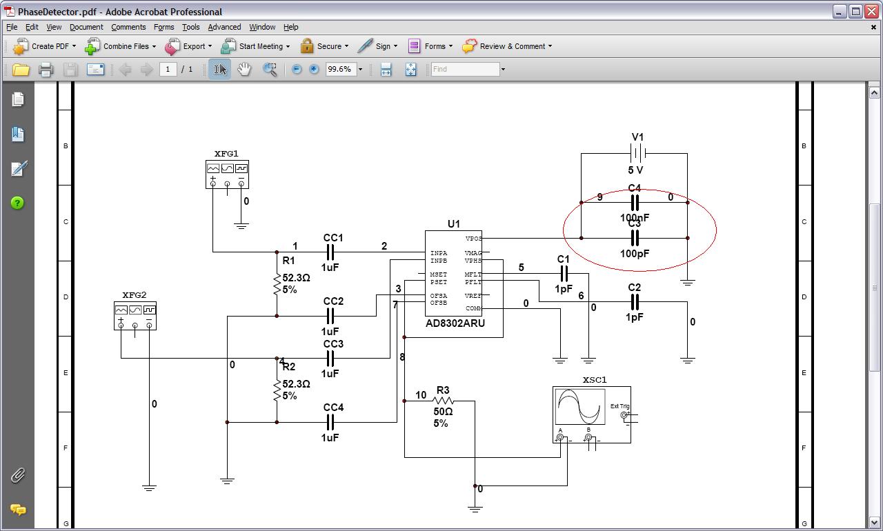

I have designed the phase detector circuitry, but I wonder if those are the suitable value for the components used in the circuitry. Any comment on this circuitry?
  • PhaseDetector.pdf
I would reduce the bypass and coupling cap values to 0.1 uF instead of 1 uF. Otherwise, seems OK. You would be wise to copy the application pcb layout in the data sheet, page 21.
Well, I am thinking of providing the power to the Phase Detector using a power supply, thus I have made changes on the diagram... Do I need to add extra capacitors to the power supply part as what have been done in previous design (as shown in the picture below)?
The only critical point where you must have a ceramic bypass capacitor is from Vcc to ground as close as possible to the chip.
