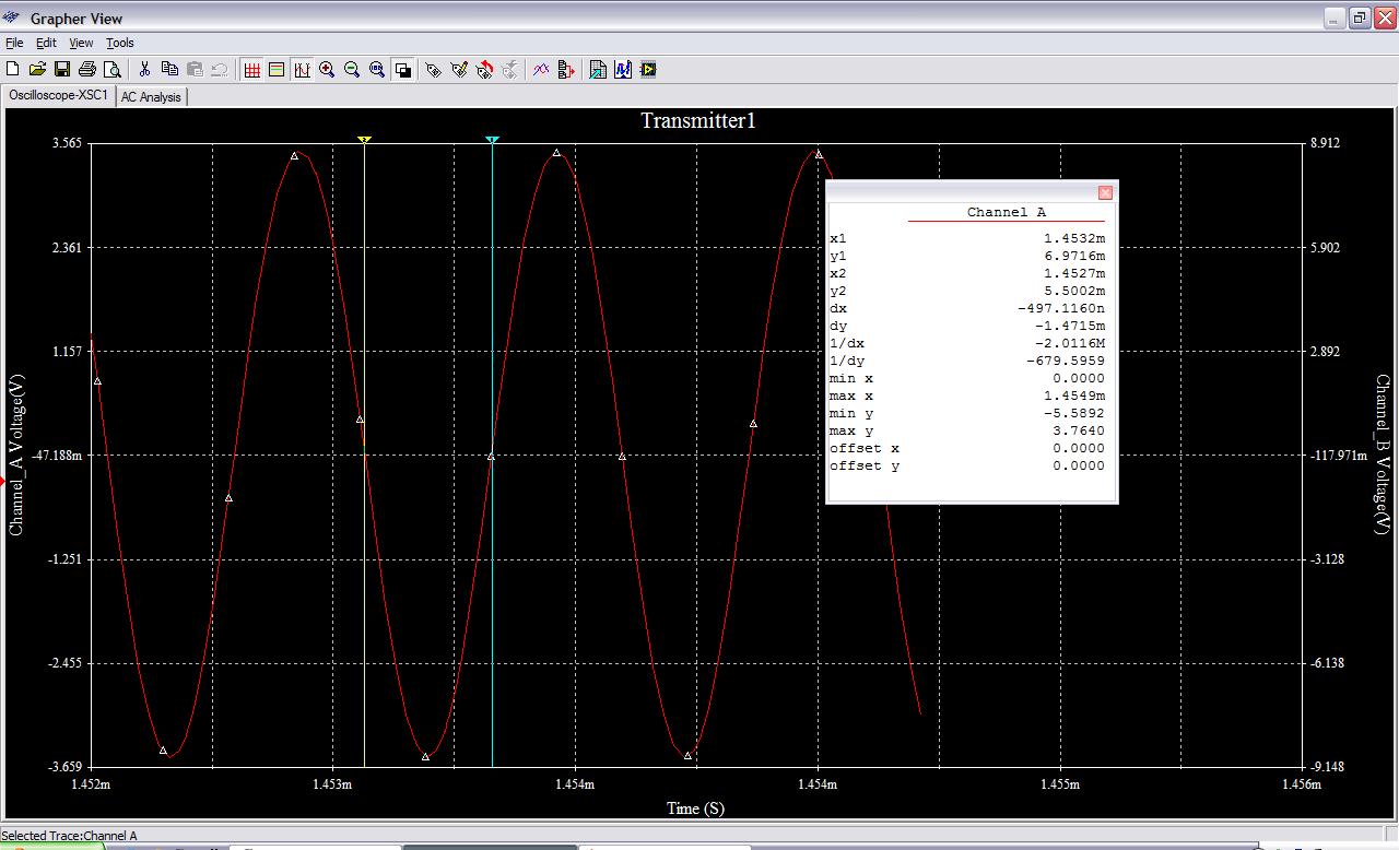

Well, I have redesigned this circuitry for the amp. The output is better than before, but the output waveform is not desirable. Any comment on this circuitry?
The output waveform tells me that the collector tuned circuit is not doing its job. In this kind of amplifier the transistor is turned on for approximately one half cycle at the input's frequency. We can see in the output waveform that this is indeed happening. However, when the transistor turns off during the other half cycle, it is the job of the resonant tank circuit attached to the collector to fill in the other half cycle by ringing. Ringing means allowing the stored energy to freely trade back and forth between the capacitance and inductance and in so doing having a current move around the tank circuit back and forth between inductor and capacitor at the resonant frequency of the tank. Since the current is moving back and forth, the voltage is therefore going up and down as well during ringing. The overall effect is that it smooths out your output waveform to become a perfect 1MHz sine wave. However, yours is not.
You can see some ringing effect during the off cycle. We can use this to estimate the actual resonant frequency of the tank circuit. I see 5.5 cycles of ringing in a period of .5838 microseconds which is a frequency of 9.42 MHz. Assuming that the capacitors in your tank circuit are still fully involved, which is a safe assumption, this means that only 4.4 uH of inductance is involved in the tank circuit. As you can see, you have 4.7 uH on the hot side of your output point at which you have attached a 50 ohm load. So I conclude from this that the load is tapped far too heavily into the tank circuit and the 470 uH inductor is carrying no current.
You can test this by removing the 50 ohm load and viewing the resulting output voltage.
To fix this, you need to tap the 50 ohm load much higher towards the "cold" side of the inductor. Then you should vary the capacitor a little bit to maximise the output voltage.

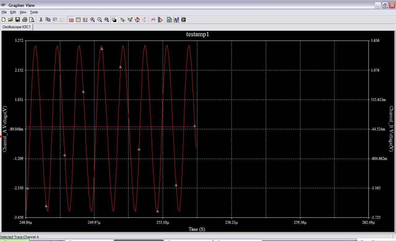

Alright, I have redesigned the amp (classcamp.pdf) by following your advices. The output now is desirable, as well as the output power (input+output.jpg)(output.jpg). Any comment on it? Is it alright to put a emitter resistor with such a small value? (5 ohm, it seems too small for me by the way...)

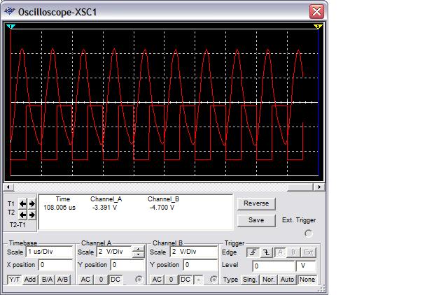

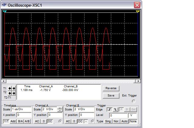

I have finished cascading the oscillator with the class c amp. The output is desirable. However, the waveform is distorted (distorted.jpg) and shifted when the circuit initializes, and becomes stable (stable.jpg) after certain period (initialize_output.jpg, input_vs_output.jpg). Why this happens? Any comments or improvements on this oscillator?

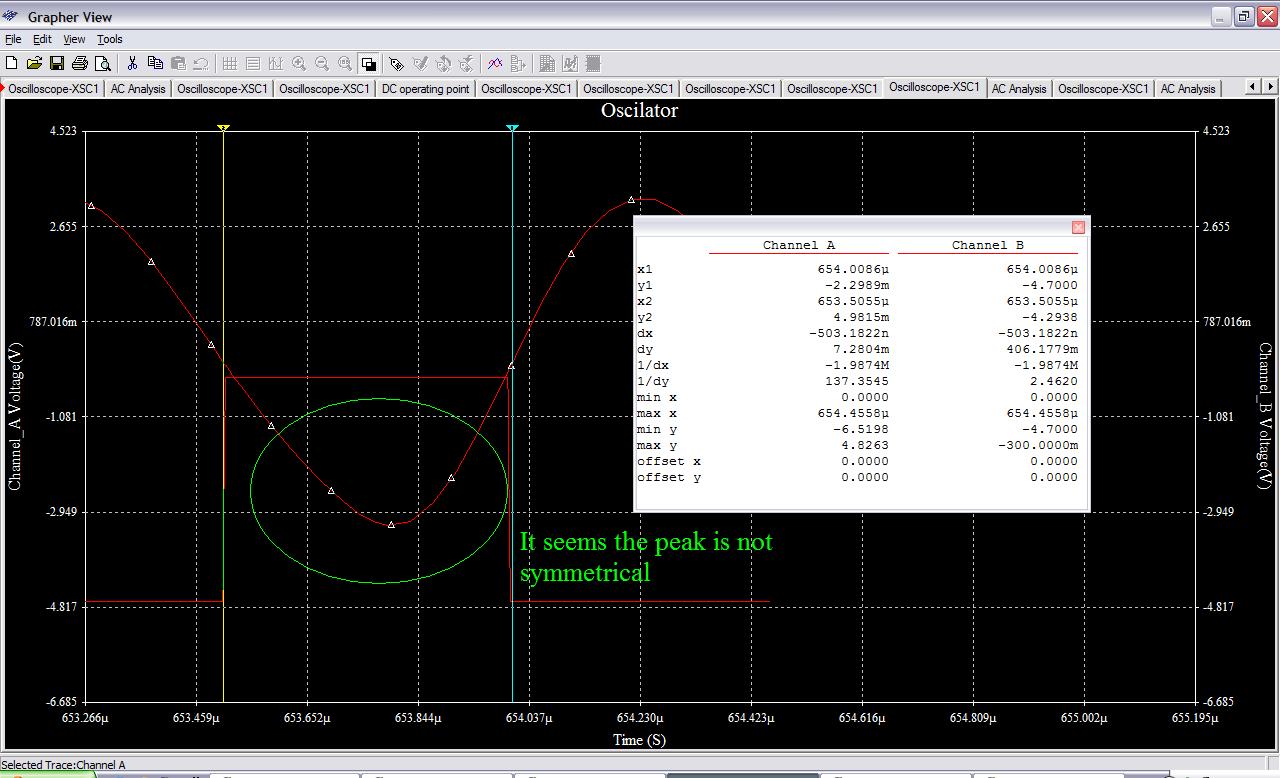

Besides, i found that the stable output waveform is not symmetrical (please refer to nonsymmetrical.jpg). Why this happens? Is there any approach to reduce the distortion?

I am not sure about the distortion, but I have some possible explanations. During the negative half cycle of output, the transistor amplifier configuration simply is not very linear in its operation. The best way to understand this is to plot the input and output signals on the set of characteristic curves (collector current vs base current) for this type of transistor and see how the current gain is changing depending on the moment by moment input current magnitude. So the output voltage will be somewhat nonlinear and this is what we see on the negative half cycle.
On the positive half cycle, it would be different since in this half cycle the transistor is turned off. In this case, any distortion in the positive half cycle would be attributed to the inability of the tank circuit to remove enough harmonics to purify the waveform. So in addition to 1 MHz energy in the output tank, there is harmonics which are put there during the negative half cycle nonlinearity of the transistor operation plus the nonlinearity of the input signal to begin with. these harmonics are well attenuated, but not enough to eliminate them completely. The way to purify the output is to cascade another tank circuit to act as a band pass filter. Another way is to design a class C amplifier with a more linear device operation, but this is much less practical than adding an additional filter. All transmitters using class C power amplifiers include a substantial multi-pole (i.e 3 or more) low pass filter just before the antenna to remove harmonics created by the nonlinear class C process. So a bandpass filter would work well for you, or a low pass filter and a low pass filter is sometimes a bit easier to do. If using a low pass type, the cutoff frequency should be above 1 MHz but below the 2 MHz harmonic, so usually these are designed to have minimum attenuation at 1 Mhz but to have the cutoff frequency as close above that as possible.
I think that you can use any rf choke or inductor that fits your criteria. The most important includes the series resonant frequency, which must remain well about your frequency of operation, your be careful of the maximum DC current above which you might burn the choke.
edit: The behavior of the oscillator after power-on is normal. All oscillators build up to their stable operating condition rather slowly (that is, not instantaneously, but rather over periods that range from tens of microseconds to hundreds of milliseconds) after DC power is applied. This is because when DC power is first applied, the oscillator is in some random state. Imagine that the amplifier part of the oscillator is immediately ready to amplify but it has not received any feedback from the output yet because there is no oscillation to start with. Now, imagine that it is a very high gain amplifier and will amplify any tiny bits of noise or AC of any sort at the input and in fact is not happy to remain at a stable voltage because of its unstable design. When it does amplify the tiny bit of noise at the input (there is always a tiny bit of noise in everything), it then can feedback some part of this to the input thorugh the resonant circuit and begin its real function of amplifying only one particular frequency.
