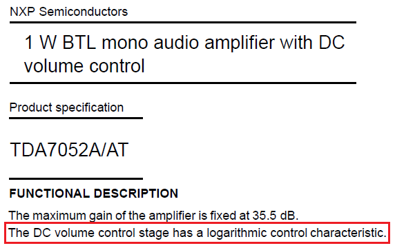

The DC volume control is an ordinary 1M linear potentiometer available at any electronic parts distributor. Digikey has thousands in stock of 74 different manufacturers, shapes and sizes.
I do not think it is a 1M logarithmic volume control that might be rare.
I did find some on ebay but wouldn't having linear pot defeat the purpose of having an amp to listen to use? I'm guessing there would be no way around the 1m pot either way?
a 1Meg pot with "A" taper is log taper, so the part would be marked "106A". a linear taper would be a "B" taper, so it would be "106B". whether the pot is used for a control voltage, feedback loop gain set, or input voltage divider, the effect of the log taper is the same, so yes, you want a log taper pot.
edit: the data sheet says the voltage control has a log characteristic, so you want to use a 1Meg LINEAR ("B") taper pot.
A linear pot is used and the IC makes it have a log function. It says so in the new datasheet by NXP semi

If you are using a volume control on the signal source then the TDA7052A can be permanently set to maximum gain if the 1M pot is replaced with a 1M fixed resistor. The 1μF capacitor also should be parallel to it.
