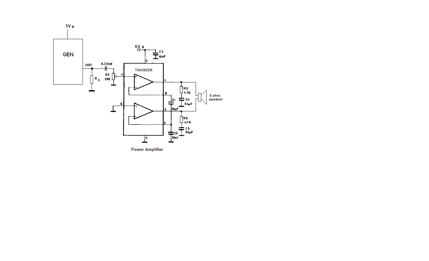

Enclosed power amp
posted in #49 with 0.22mf capacitor for cut-off freqency plus coupling cap
Will this circuit work (as is) or do i need to add or delete any part to this bridge amp.
The output emitter resistor will be added is the placement of resistor correct. Please advise.

Enclosed power amp posted in #49 with 0.22mf capacitor for cut-off freqency plus coupling cap.
0.22mF is 220uF and its value is 1000 times too high. If its value is 0.22uF then when it feeds the 10k volume control the cutoff frequency is 73Hz so deep bass sounds will not be produced. It is fine for voices and touch-tones.
The output emitter resistor will be added. Is the placement of resistor correct?
The "emitter resistor" is connected to the output of the DTMF generator IC. Do you want to add a switch for other inputs to be played through this amplifier?

For the coupling capacitor I did mean 0.22uf its micofarad. right! So 73hz would be pretty good voice and touch-tones.
Is the emitter resistor placed correctly in the circuit..
For the Generator circuit its purpose is only to emitter the touch-tones through the Bridge amps speaker in post #49,as mentioned in post # 1..

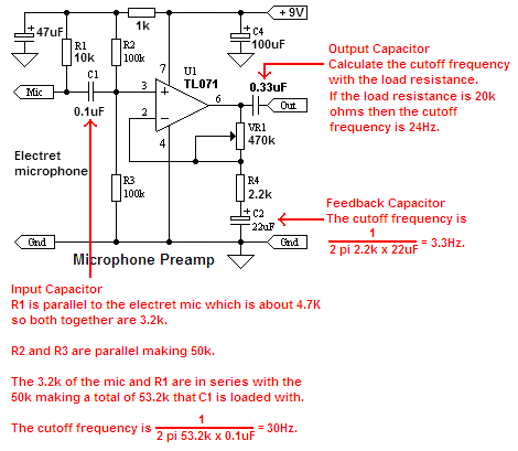

I Can calculate for the RC cut-off freqency for the bridge Amp and the headphone amp, But the Preamp that you posted I have no idea how to change the input cut-off freqency below 10 hz since you post that circuit for me but i think you set it at 32Hz. in Post #7. Help. can you change it if it needs to be changed.
The bridged amplifier has only one coupling capacitor which is the output capacitor of the preamp.
I show cuoff frequency calculations of the mic preamp on my sketch.
The feedback capacitor creates a cutoff frequency too low at 3.3Hz so its 22uF capacitor could be 2.2uF.
For voices a total cutoff frequency of about 50Hz sounds natural. A total cutoff frequency of 300Hz sounds tinny like a telephone.
Then select individual cutoff frequencies for all RC circuits so that the total is about 50Hz.

I'm not quite understanding what needs to be calculated here. In your sketch where theres 30hz cut-off freqency on the Preamps input dose that freqency need to be lower then 30Hz Or dose this freqency stay at 30hz but adds to the capacitor on the output of the Preamp capacitor which feeds the input cut-off freqency on the Power amp and the headphone amp cut-off freqency to total to 50Hzs as you suggested...
What about the feedback cut-off freqency. How dose this freqency play into the Preamps output capacitor.
Dose the feedback capacitor need to change know matter.If i change the 22uf to 2.2uf which will give a cut-off freqency of 32.88Hz on this feedback circuit instead of 3.3Hz.. Dose this freqency change an adds to the 30Hz thats on the input of the Preamp. I'm Totally confused on this. Help!
