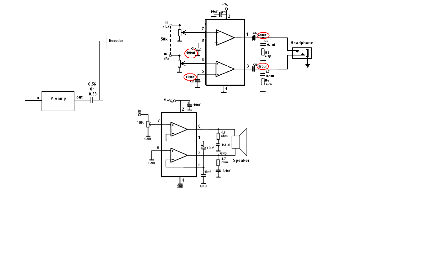

Enclosed Amplifiers. Please edit the schematic so i can understand what capacitors to add and what capacitors need to be calculated on both amplifiers for a total of 50Hz or less.
1.When the Preamps output is connected to the headphones left and right inputs on the amp dose the Preamps output (0.33uf 0r 0.56uf which ever one is used) coupling capacitor get connected to the headphones left and right inputs to. Or are the two 100uf capacitors on the headphones amp are those the input coupling caps for the headphones amp and the two 470uf caps are the headphones ouput coupling capacitors.If this is the case then the preamps output capacitor (0.33 0r the 0.56) dose it still need to be connect to the headphones left and right inputs . Yes or No. Advise?
2. When the Preamp output is connected to the bridge amp with speaker and switch over with a on-on switch the preamps output coupling capacitor 0.33 or the 0.56 is connected to the bridge amps input because as you stated there is no input coupling capacitor for the bridge amps input. And are the 10uf or are 0.1 caps on the bridge amps output the coupling caps.. Yes or No. Advise?
3. Now when I insert a stereo Plug into the output ear jack on a portable FM/AM radio then the other plug connects to a audio jack on my device then gets connect to the Headphone amplifier input when the Headphones amp switches over to the radio output will my audio jack need a coupling cap for DC voltage coming from the radio output or will the radios output suorce already have this coupling capacitor or the headphone amp on its input and output block for DC voltage. If this make any sense.
You should always have part numbers for ICs on your schematics. I don't know which decoder IC you have and I don't know the value of its input resistors.
I also don't know the impedance of your headphones.
1.When the Preamps output is connected to the headphones left and right inputs on the amp does the Preamps output (0.33uf 0r 0.56uf which ever one is used) coupling capacitor get connected to the headphones left and right inputs too?
The output coupling capacitor of the preamp connects to the decoder and to both volume controls of the headphones amplifiers. I don't know which decoder you are using so I don't know if it needs an additional input capacitor.
Or are the two 100uf capacitors on the headphones amp are those the input coupling caps for the headphones amp?
No.
They are not input capacitors. They are feedback capacitors.
and the two 470uf caps are the headphones output coupling capacitors?
Yes but I don't know the impedance of your headphones so I don't know if the 470uf capacitors produce a 50Hz cutoff.
Bad english.
And are the 10uf or are 0.1 caps on the bridge amps output the coupling caps?
No. The 10uF capacitor is the feedback capacitor and the 0.1uF capacitors stop the IC from oscillating.
Bridged amplifiers do not need output coupling capacitors.
I don't know if your radio has an output coupling capacitor so you should add one or two. Is your radio mono or stereo?

Here's the information that was not included to edit amplifiers which was needed in post# 96.
The decoder IC is the M8870 its in Post #6. I will not be using the 74LS148 for the display decoder. I have another IC in mind to control the display.
Here the datasheet.
http://www.datasheetcatalog.org/datasheet/clare/M-8870-01SMTR.pdf
The impedance of my Headphones are 8ohms and 16ohms and i also have a 32ohm pair. But I use the 8 and 16 ohm headphones mostly for the portables.
1.The coupling capacitor for the decoders input is 0.1uf, If I use that capacitor for the decoders input how would the preamps output capacitor affect the decoders input shouldn't the 0.1uf be remove on the decoders input so the preamps output capacitor is used. How would that affect the decoders function if the coupling capacitor 0.1uf was removed and the 0.33 or 0.56 was used instead of 0.1uf on the input of the decoder .
3. My radio i listen to is a sony pocket mono FM/AM radio with a small 2'' speaker and it sounds pretty good for its size.
I also have a sony walkman digital tuning stereo portable pocket FM/AM radio has no speakers comes with stereo headphones they are either 8 0r 16 ohms impedance.
The decoder has a 100k input resistor and a 0.1uF input capacitor so its cutoff frequency is 16Hz which is very low for touch-tones. When the 0.1uF capacitor is in series with the 0.33uF output capacitor of the preamp then the resulting 0.077uF will have a cutoff frequency of 21Hz will be fine.
If your headphones have 8 ohms for each ear then a 470uF output capacitor will have a cutoff frequency of 43Hz which might be OK.
