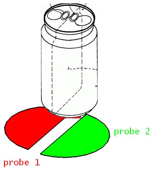

I made some experiments with cans yesterday and here is the result:
Nor is the body of the can conductive, neither is the top, not even the opening lever. The only conductive part of the can is the buttom which is untreated pure aluminum. The film is comparable to the enamel on a copper wire to make induction coils.
Poking through the laquer with the probes of the multimeter each part becomes conductive. However it requires a sharp tipped probe or a pin to penetrate the laquer and some force too.
Using the conductance measuring method could easily be done by closing two insulated tips (from each other) via levers thereby poking small holes into the can, similar to a fork used to lift animals digestional leftovers. (Sh... :)) This could be done without poking holes into the fingers by positioning the probes out of reach of hands.

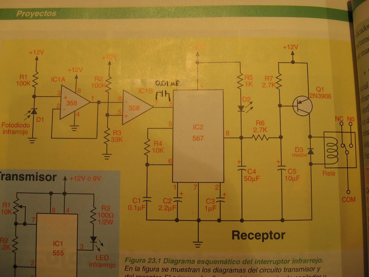

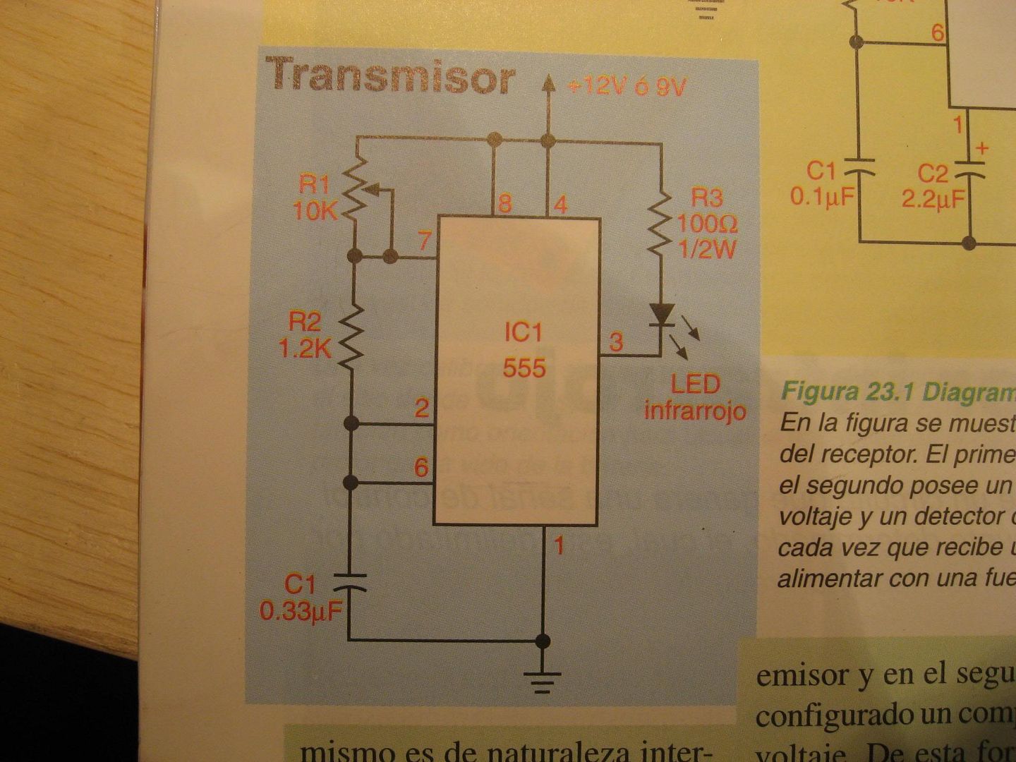

Well it has been a pretty cool industrial design discusion, but I think the OP fell asleep waiting for the circuit. I'm too lazy to re-draw it, so I photographed it from my old book
If I have some mistake please warn me, I'm not very experienced
https://i74.photobucket.com/albums/i264/menticol/Me23026.jpg
https://i74.photobucket.com/albums/i264/menticol/Me23027.jpg
The hand writting on the receiver is to correct a mistake on the book, they forgot to add that capacitor.
To calibrate it, put Emitter in front of Receiver, and turn pot until relay turns on. Connect relay's NC pin to 555 timer circuit (mentioned posts before), so when the beam is broken the 555 is triggered.
I think the receiver's relay can be removed, and the 2N3906 colector be connected directly to 555 circuit trigger through a 2N3904 NPN.

Nice job Hans! I have never imagined the top wasn't conductive, but only the bottom. There's a problem with the sharp tips as sensors / poking into the can. When the can is crushed, the sensors will be buried into the can, breaking them or changing it's shape.
The IR solution is more suitable, but harder to build for the inexperienced OP. So I suggest to use the flat sensor I mentioned before, wired to the 555 circuit also posted before
