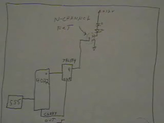

how is this for a quickie design
it would require per side..
3 cmos flip Flops
1 CD4022 counter..
and of course the 6 FET's , LED's and some resistors..to limit current flow..
the 555 can be used for both sides...

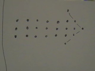

williB said:
they come two flip flops per chip..btw
Just one Slide Per side

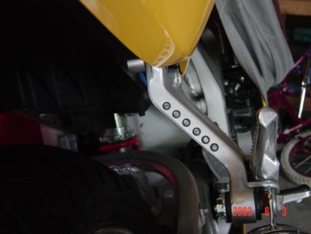

here is pic of how my side is right now with LED they just Blink
no sequence...
3 cmos flip Flops
1 CD4022 counter..
ALso CD4022 counter would work better then LM3914? or is it the same

yeah .. three Flip Flop IC'sPer side....six in total .. one for each stage..the FF hold the pulse sent to them by the counter.. till they are reset by the carry out pulse from the cd4022..

Sorry Willi,
Don't you think that the LM3914 circuit will be much simpler?
1) Set-up the LM3914 as a bar-mode voltmeter. It can output up to 30mA per LED so 20mA is easy. Current-limiting resistors for each LED will keep the LM3914 cool.
2) A PNP transistor current source charges a cap linearly, and the LM3914 displays the cap's voltage. A trimpot can adjust the ramp's speed.
3) The 7th output of the LM3914 discharges the cap.
4) A voltage regulator (zener diode?) keeps the ramp at a constant speed.
Really simple.
