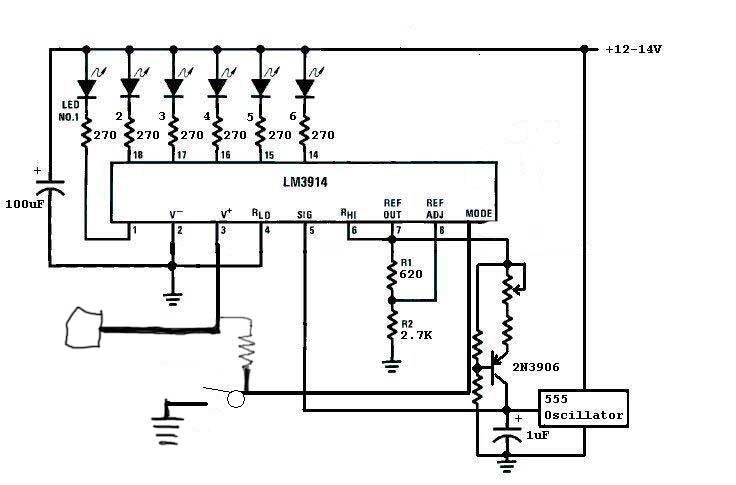

here is the toggle switch schematic does it look right?
it shoudl be correct i found it on another website instructing me to to do it this way..

I dont think that toggle switch is right, you need the mode connected to either ground or +VCC, it wont work without it (I'm using a LM3915 for my led project and I just discoverd this out tonight).
Here's how you'll have to do it (I'm not sure if you'll still use this circuit or what, its hard keeping up with this thread.)
the resistor i added will function as a pull up resistor. The box there is supposed to go to VCC some how the paint program got deleated off my comp so I had to use an impossible program to draw it.
Oh, I would think a 1k resistor would work for the pull up.

Hi JRZ,
Never mind guessing about an unspecified resistor, just connect the mode pin directly with a switch as recommended by the manufacturer:

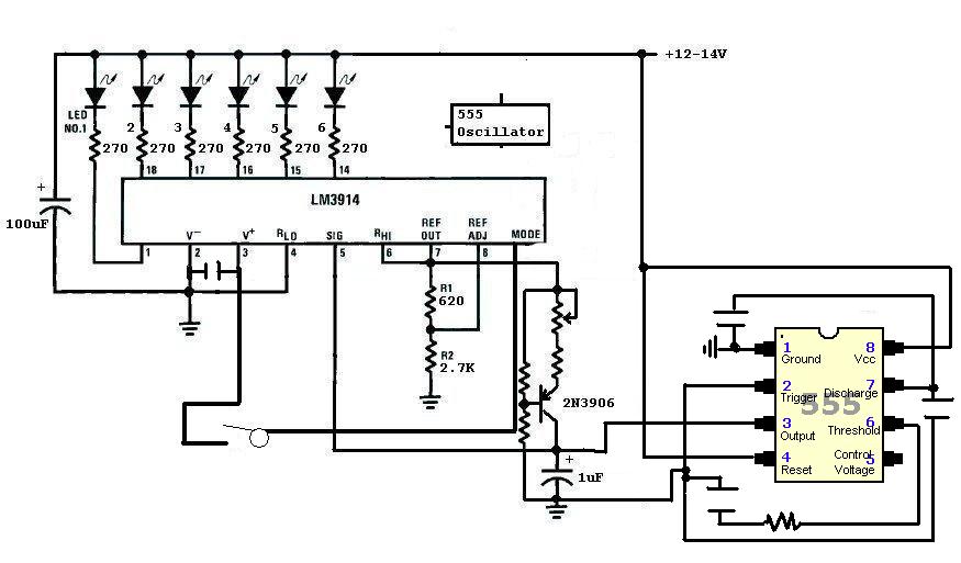

Okay how does this look
i added 4 new cap each one .1uF
also added a resistor
found it that way on a website searched for "Astable operation 555"
here is the website https://www.tel.uva.es/~tri/tutorial.htm
thanks
Max

audioguru said:
Hi JRZ,
Now that I think about it, I might have had a loose wire as well :oops: .
In the schematic above, is the +12V input supposed to be connected to the V- on the IC?
Also, I found this program awhile back, it's pretty handy to have for calulating the pulse from the 555
I never though about needing a decoupling cap. for this IC, maybe that's why the LED's flicker when I input a low frequency audio source. I'm gonna have to give that a try. Looks like I need to consult my datasheets more closely. :wink:

Sweet i guess this Circuit will work, I don't know why +12V is not connected to V- on IC on other circuits i seens it connected to PIN3 but Audio hooked it up that way. so i guess he will have to explain.
Max
